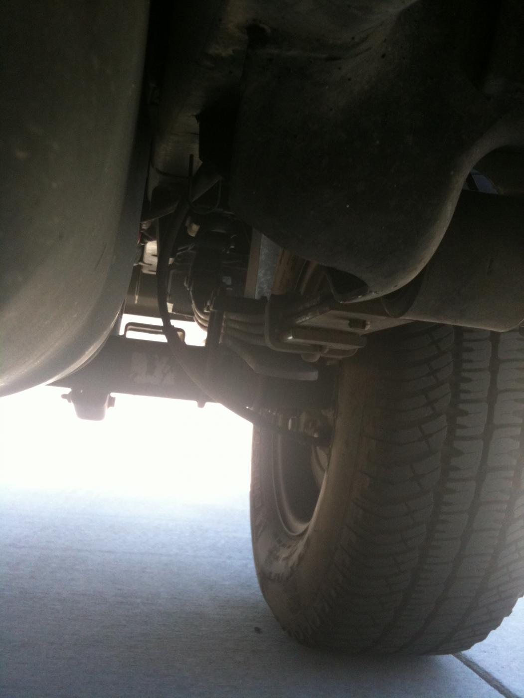

Tom, I have a 2005 1500 quad cab 4x4 and my springs look just like yours. I have never towed anything and only haul a few light loads here and there. I have recently developed a horrible ride. Bed seems to bounce and vibrate bad. Had wheels balanced and rotated. Didn't help. Put on new Rancho shocks and didn't help. Started to suspect maybe bad leaf springs, but not sure now that I see your springs look like mine. Have taken it a several body places and suspension places and nobody can figure it out. Maybe this is how Dodge springs look?

Tom,
Here is a picture of my springs...Sorry, not the best picture..Again I have a 2005 1500 quad cab 4x4...I looked at my friends 2005 1500 quad cab 4x2 with only 25,000 miles on it and his springs look exactly like yours...He doesn't tow/haul anything either, so starting to suspect this is how our springs are supposed to look or there is an issue with them all.
