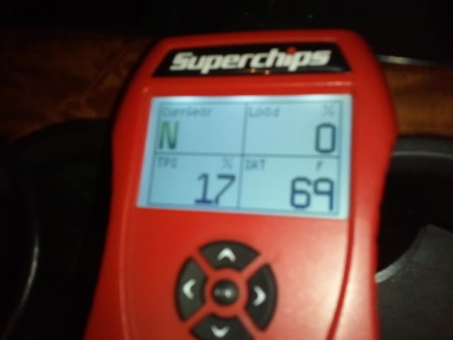

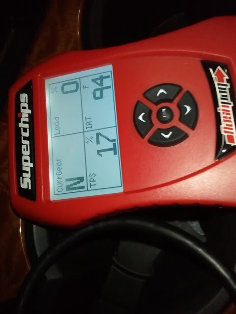

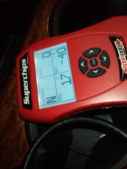

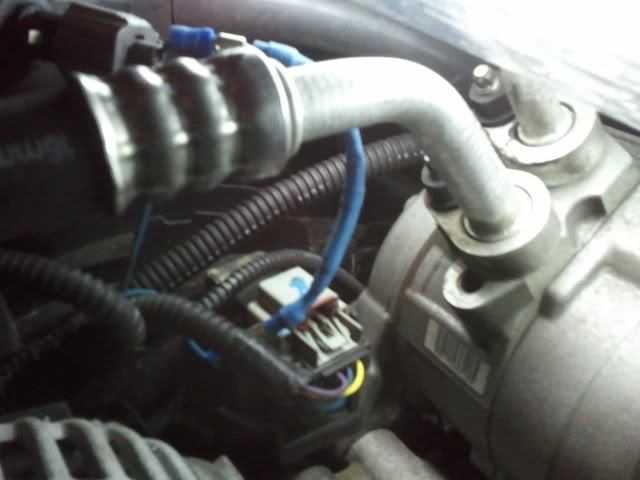

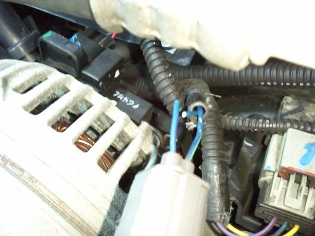

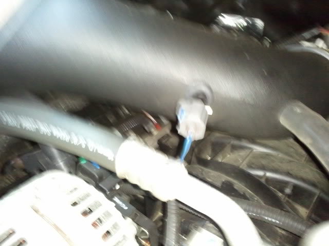

weed made the power wire and installed it watched the temp drop 20 degrees to.
thanks the vid could have done it otherwise.
