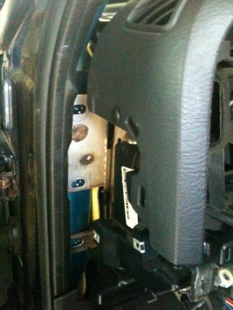

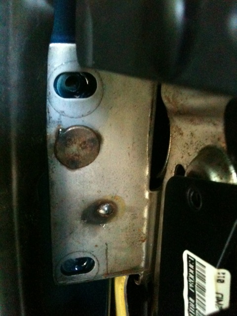

Currently my truck HVAC is not working properly. The air blows cold and hot as I turn the temp dial and I can change which vents the air comes out of with no problem. The blower motor works fine. I already pulled it to check. When the HVAC is on I can hear all kinds of air movement up inside the dash, but hardly anything comes out. I pulled a few of the solenoid actuators to check and see if they worked and all the ones I could get to without pulling the entire dash work fine. So I determined that I am going to have to pull apart the duct system to find and fix my air flow problem.
I have the service manual and the haynes manual. I have pulled every bolt and screw listed in those and every other one I can get to on the dash. I have disconnected all the connectors attached to the dash. I have removed every panel on it. I have also lowered the steer column and removed the steering wheel. I cannot get the dashboad to come off it is stuck quite solid on the driver's side.
The drivers mounting plate (not sure if that is the correct name) has a spot weld on it. I am wondering if some retard at the factory spot welded the driver side mounting plate in place to make easier for him to install the mounting bolts that attach it to the frame. The passenger side is held up with a small hook in the mount that slides into the frame, the driver side does not appear to have this feature. Below are two pictures of the mounting plate with the spot weld. What could this weld possibly be for? I can't see any reason for it to be there.
I am about to start drilling out the weld, but I don't want to mess something up that I can't fix. Any help or advice you have would be appreciated.

Thanks for the link Weedahoe. That guy mentioned two hard to see bolts attaching the steering column support to the dash. I thought I got them all, but I went back in to look again and there they were. I removed those and the dashboard came right out.
Still not sure why that spot weld is there though, there is nothing that attaches to the mounting plate there. The guy who posted pictures on your link has a spot weld on his too in the same place. Just weird.
