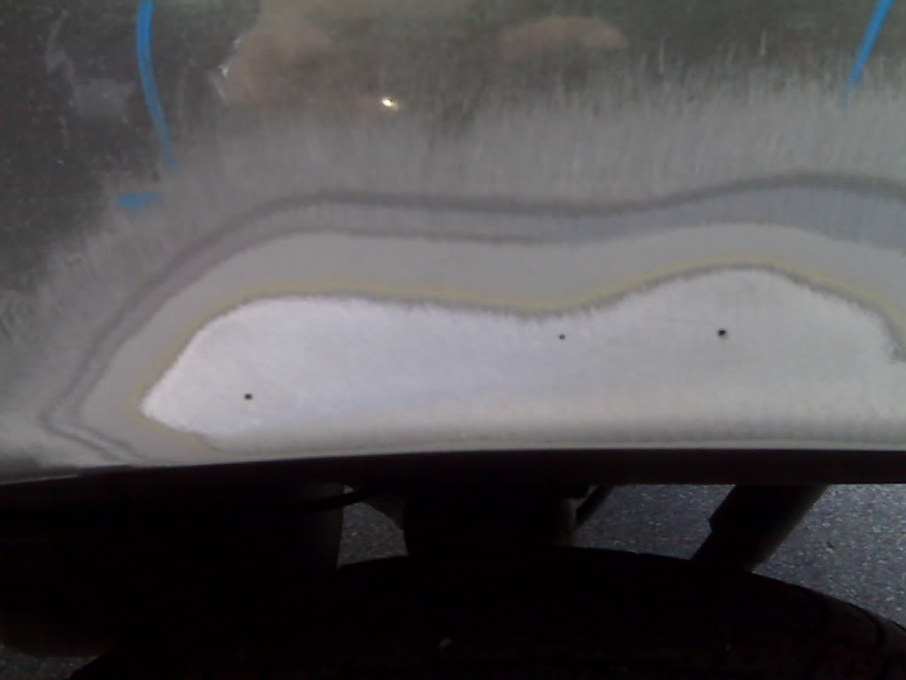

Pull your tail lights and have a look at the back side of the fender. You will shocked by the mount of rust. And the bubbles are actualy rust holes. This is my truck
I would go to the dealer and see if they will cover under warranty. You have 5 years on rust through.

now there are actually no holes in the outside but it has bubbles and i know they will form into holes
should i contact HQ or just go to my dealer?
