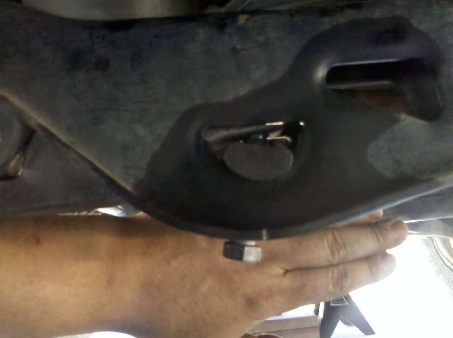

Hey, I have not posted on here in a long time but I read the posts often. For once I have a question or two of my own. Over the past weekend I installed skyjacker leveling keys in my truck. It seemed to go okay. I rented a big ball joint press from Auto Zone and the job didn't seem that bad. However, now the left bolt and the block it threads through won't seem to sit right. It's at an odd angle. The other side is pretty much straight vertical. I even went back and unloaded it, removed it, and replaced it and it did it again. The thing is just sitting about 10 or 15 degrees off of vertical. I've had it aligned and driven a few hundred miles this way. How concerned should I be? What may be causing this?

I see this all the time and its just something that happens with aftermarket keys. Usually its from the dimple being drilled in the wrong spot. Either too far out or to far in.. But it doesnt hurt anything. I'm not sure what its called, but the thing that holds the keyway bolt is made curved so it can adjust to the angle.
If I were you, i would see what Skyjacker would say, maybe they can send you another key.

Yeah, I thought about that but if it's not a huge problem I'm happy to just leave it there. The last thing I want to do is go rent the tool again and go through the effort of changing it out again.
