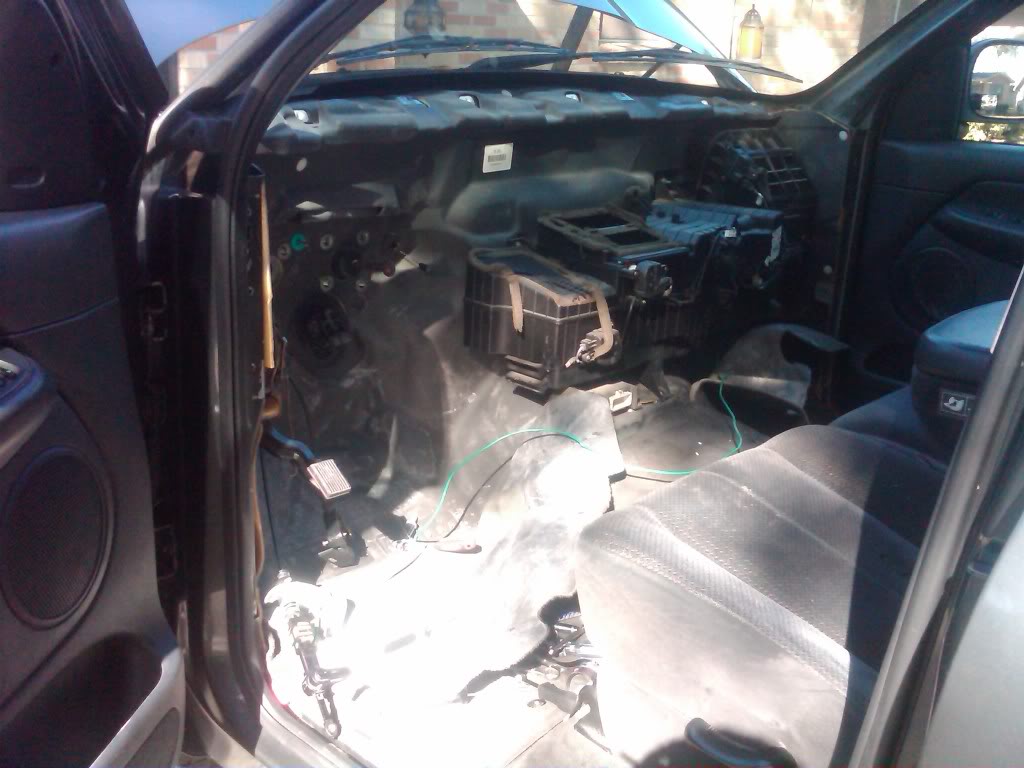

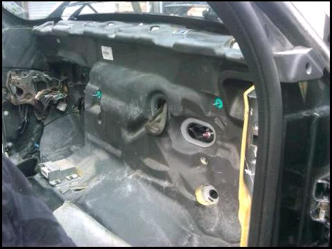

Its a pretty involved job but not particularly hard to do. You have to have the a/c evacuated by a shop before you start and plan a few days to get it done. It took me 2.5 days to get it all back together not counting the defrost panel I had to order because mine shattered when I took it off.
