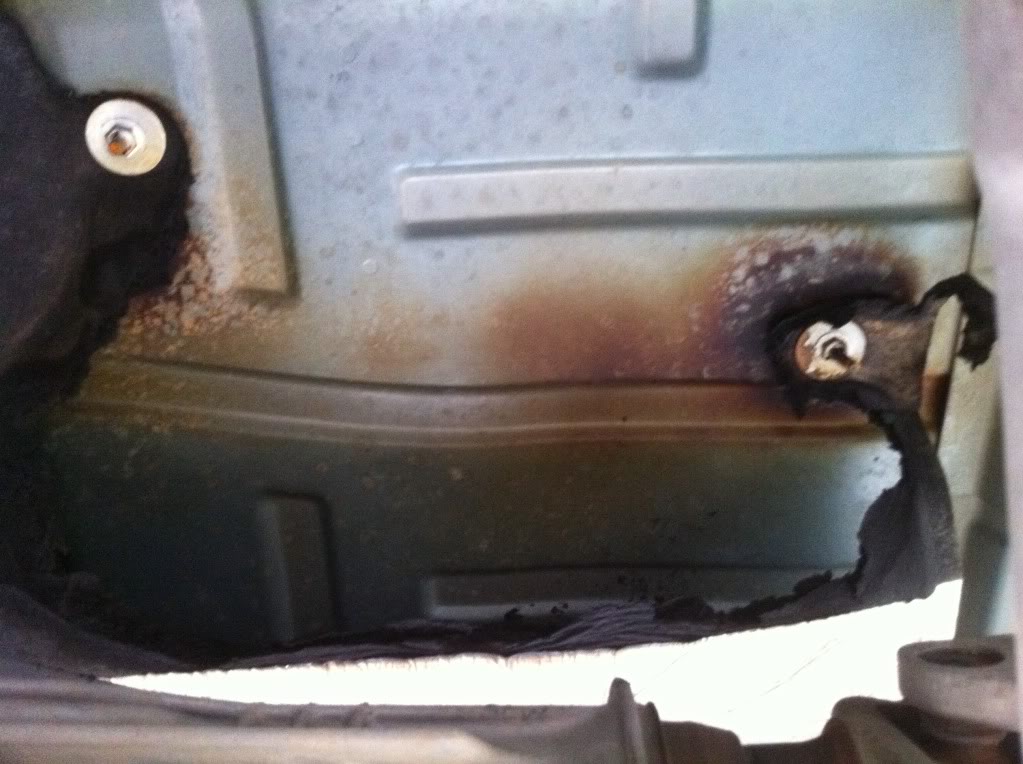

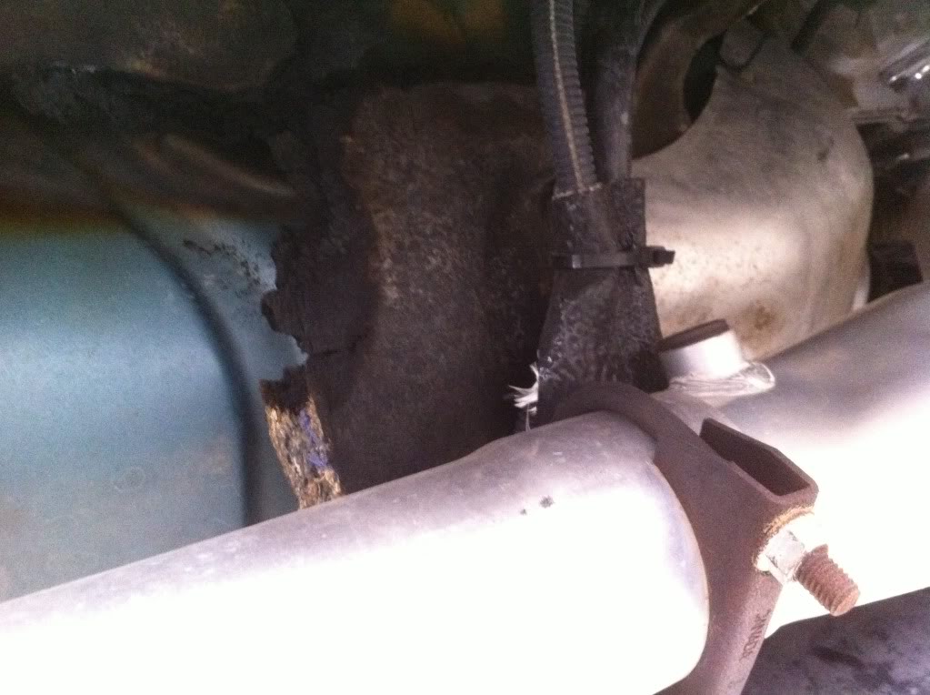

Well... this is what happens when your heat shield contacts your exhaust system... lol.

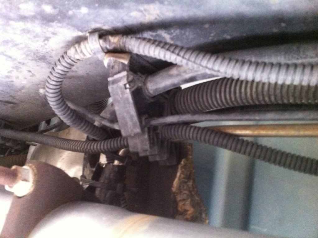

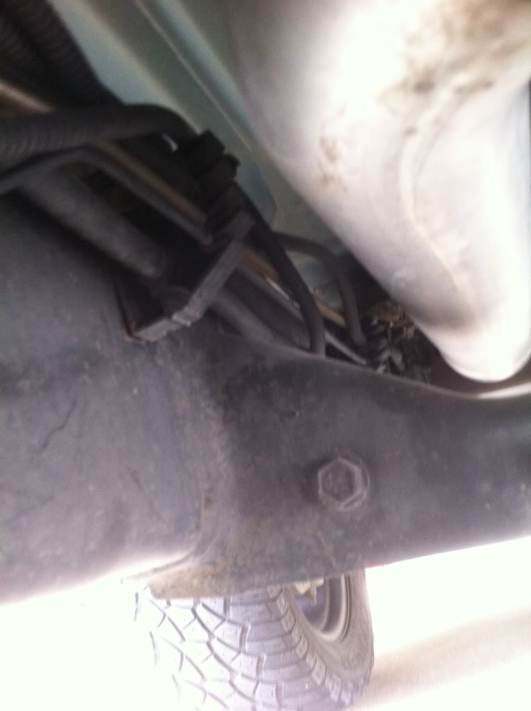

These are all underneath the driver side just right about where the Header meets the y-pipe.
The one thing that makes me think the heat is really getting to them is that on the way back from a 7 hour trip, the lightning bolt deal came on and the transmission started acting all funny and not upshifting. I thought for sure it got ahold of a wire in this loom and I think the throttle body control wire runs through there, too -- but don't quote me on that. So we get home and I let it cool down. Start it up and haven't had a problem since.

IDK man. Even though I am like hammer and have ceramic coated LTs, you have things too close to your pipes or your heat shields are already damaged and no in good shape. I will try to get some pics of mine today after work being I am getting off early today.

Well, I pulled all of the heat "shield" stuff off the bolts and out of where it was stuck.
I undid the wire ties on the clump of wires that run in between body and exhaust, then wrapped some adhesive heat wrap that is supposed to be good up to 500 degrees. Then I wrapped the black piece back and zip tied it all. It seemed to hold tighter and I didn't have any problems on the 14 hours driving back and forth to visit my parents.
I have some ideas on how to move the wires on some of the bolt studs the shield used to be on. We shall see, though. It will probably just sit in the driveway for a while now.
