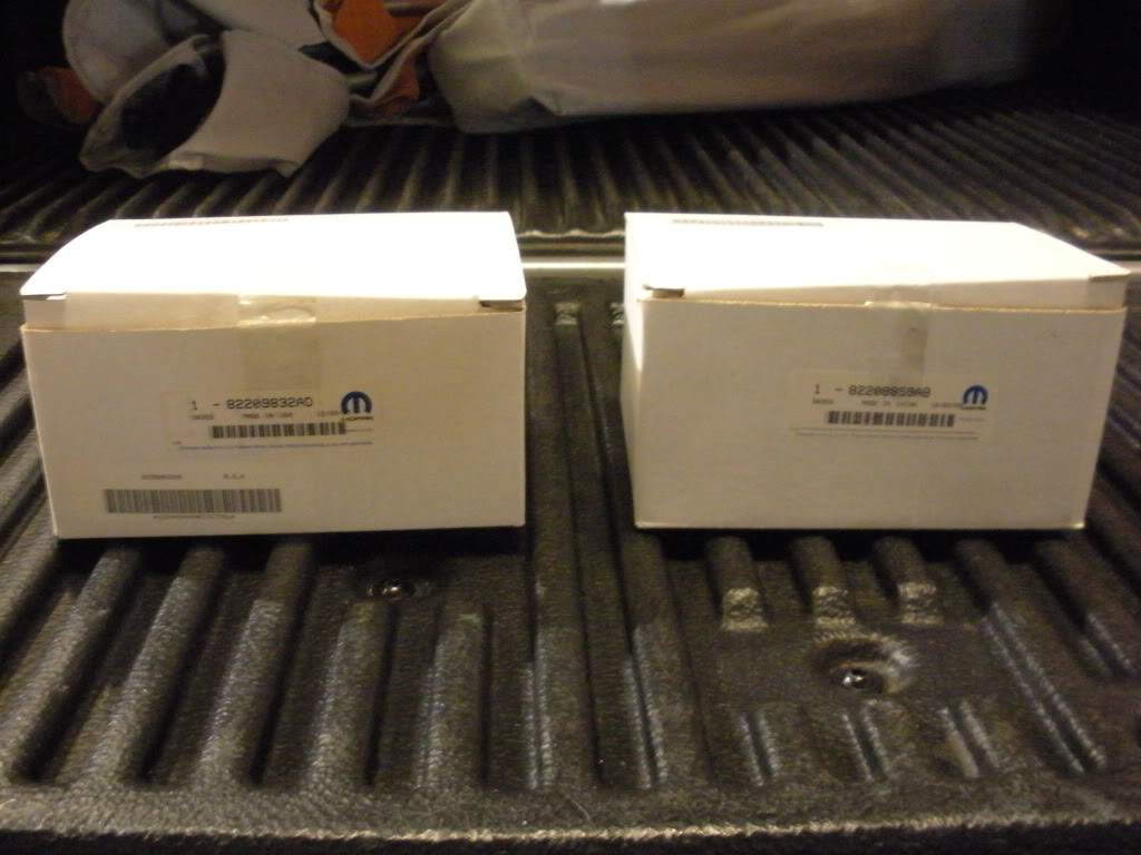

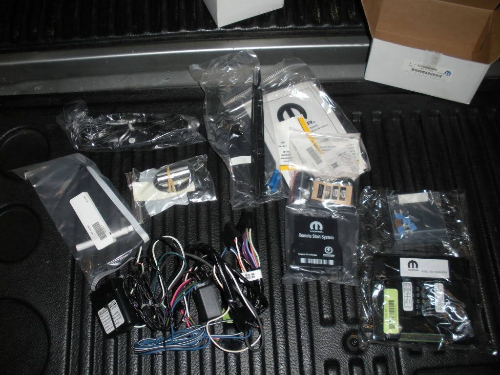

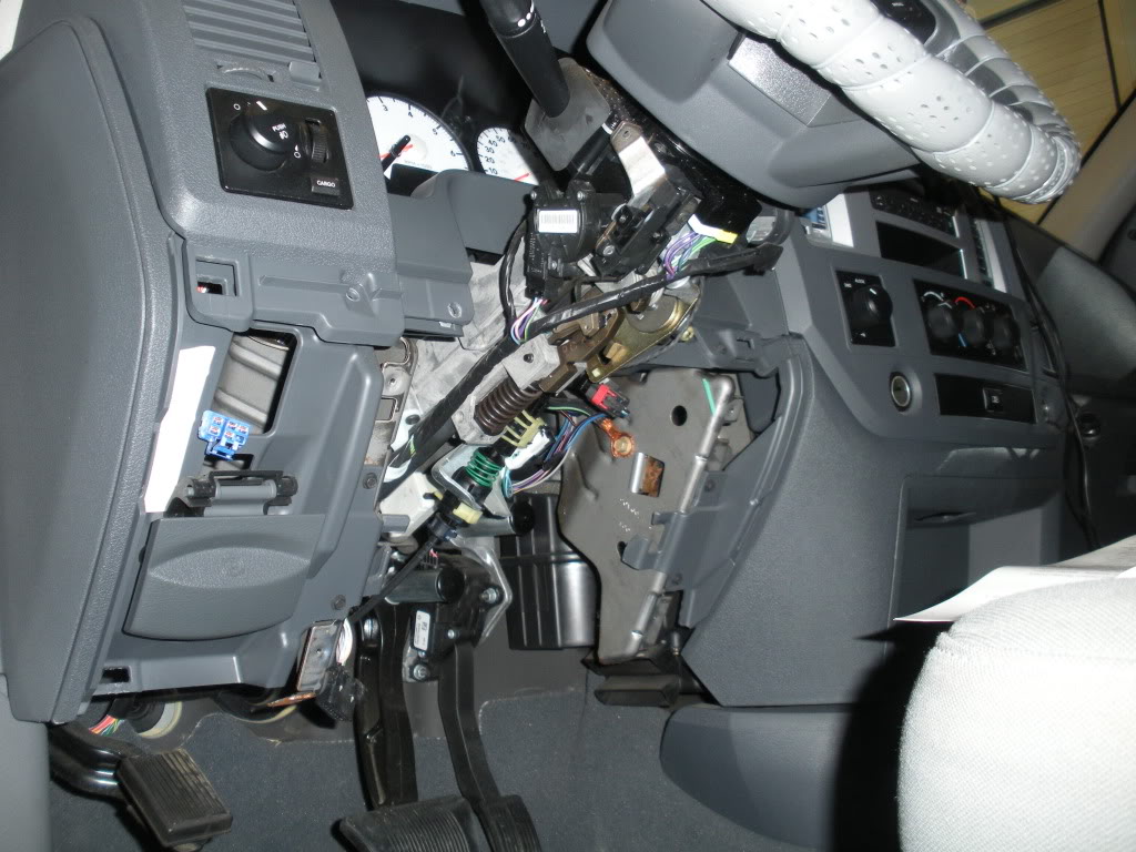

Well, got my remote starter in the mail yesterday. I'm at work tonight so I decided to install it. Honestly, it was about 100X easier than I thought it was gonna be. Most of it was plug-and-play. Only had to solder 4 connections. I think it took twice as long to program the damn thing than it did to install it. I'll be honest, the SENTRY/SKREEM system was a PITA! All is working well now though. I took a bunch of pictures planning on doing a DIY but as I was trying to upload them to photobucket I somehow erased most of them. Anyway, here's what I got left:
