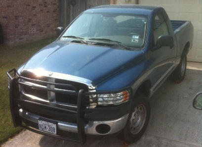

Hope someone can help. I got a 2004 Ram from my girlfriends father.
This truck only has 15,080 miles on it and has been sitting for 3 years or so under a cover (tin roof, open on three sides) in east Texas.
Truck wont start on its own, starts right up when I spray starter fluid into the throttle body, then dies after about 2 seconds.
