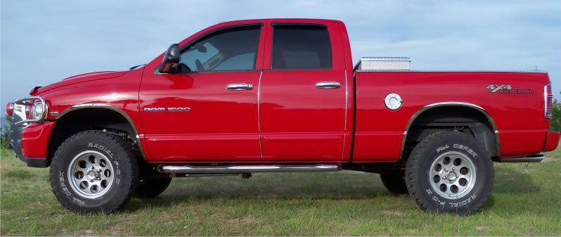

I had only done body lifts, so I researched the hell out of suspension lifts before I bought one. I am lucky enough to belong to a hunting club where about eighty percent of the guys have lifted trucks, so I got to ask a lot of questions and ride in/drive quite a few.
I chose the 4" Rancho kit because I felt it was a STRONG kit, and replaced a lot of weaker components that cheaper kits did not. Also, I found that at the time, only the Rancho 4" and Skyjacker 6" kits included a full, boxed sub-frame as opposed to either a single or dual cross-member. The Rancho and Skyjacker kits also were about the only ones I looked into that lifted at their full rating. The other 6" kits only yielded 4.5-5" and wanted you to crank up the torsion bars to achieve the rated lift amount.
This weakens the CV axles considerably. Also, the 4" lift I chose DOES NOT raise this angle at all. I actually found upon installation, that I could LOWER my torsion bars about a half inch to be perfectly level with the rear after putting the 2" blocks in the back!
I am a pretty firm believer that anything much over a 35" tire is too much (height and weight wise) for an IFS front truck to handle, so the 4"lift was plenty for me. PLUS I use my truck to haul some AND carry my ATV, and much higher would be a major PIA to be able to drive the ATV into the bed.
If you do 35's then a 4" or 6" will do, but IMO 6" of lift and 33s don't look good.
My 4" Rancho suspension lift w/35" tires:
