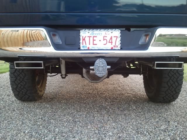

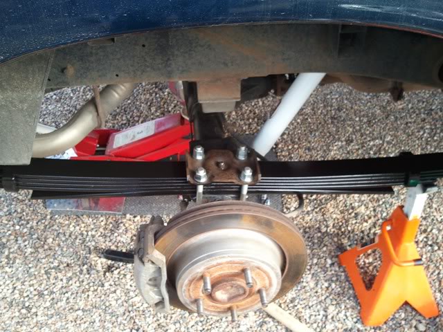

In my case my springs were wore out so bags would not fix my problem.
So I replaced them with HD version and thought the extra leaf would make the truck stiffer and bouncier. Well that wasn't the case, she rides very smooth overall now and also added a pair of rancho shocks. So nothin wrong will Airbags if your springs are serviceable and cost is fair. For the springs and shocks it cost me about 1200 with the new u-bolts and rear shackles so yes not cheap but I did gain 2 in lift do gimme back some rake to go with my leveling keys up front.
Before:
After:

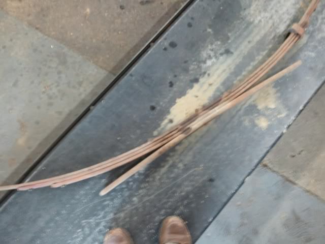

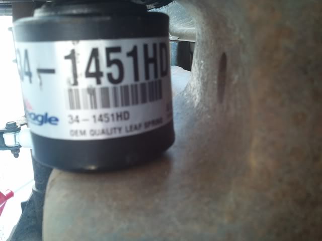

Huh...Whats a Timbren helper? All they are are HD 4/1 2050 Lbs vice stock 3/1 1700 jobbies, They are made in USA by Eagle and you can getem at any spring shop. Google Stengal bros and they sell them too, approx 350-400 ea. Hope thats what you meant.
Complete unit and come with the Bushes, of course. Torx Bolts came right out (no road salt in these here parts)

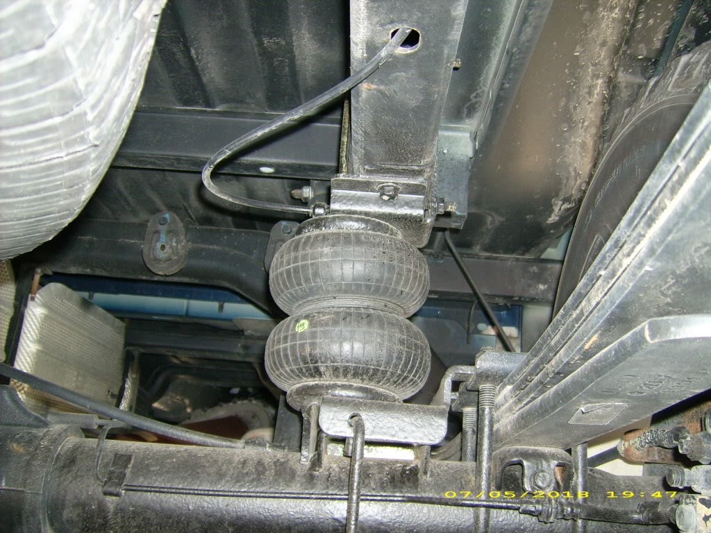

I have Anrott airbags. $225 shipped on Ebay. They hold 5,000lbs's most out of any 1/2ton bags. The hardware is super thick anodized steel. I have had mine on for 2 winters now and haven't had any issue's at all. I keep them at 10lbs when empty and the truck rides like stock. The more weight you put in, obviously the more pressure they need, but the smoother the ride actually gets. I put about 1500lbs in my bed before and only needed 45psi in the bags to hold the truck slightly higher than level. And to think the bags hold 100psi is insane.
HERE they are. No drilling like a few of the other kits require. Easy on/easy off. Took me 45min start to finish. One valve fills both bags. I mounted my valve on my trailer hitch.
And yes, I put tape on that airline where it will rub the frame...
This side also has a heat shield for the exhaust, but since i have a side exit, I didn't see the need to even install it.
Running 20lbs in them is suitable for hauling up to 500lbs as well as running empty with no ill effects. Anything higher than 25psi and the back end will start to bounce around. I have begun to leave 20psi in them all the time for easability.
