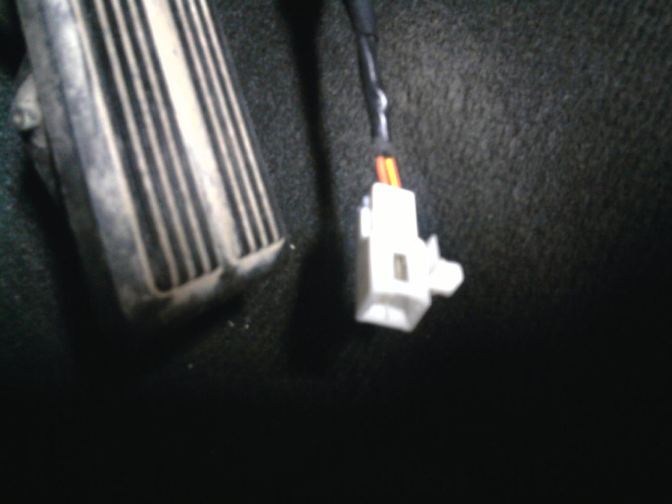

I just completed a nightmare, heater core change in my 2002 dodge ram 1500. Everything went great, but.....I have a stray wire under my dash hanging down? It is a white plug, 2 prong, female, with the soft insulation around it, composed of 2 wires, one of them is orange with black stripe and one is yellow with a red stripe. It hangs down from around steering column in a bigger harness. don't rember pulling this apart from any thing, as far as i can tell everything is working. Any idea what this is?

There are lot of connectors just "there" and not used in all models. They are there for assembly line convenience and add-on convenience. I'm not sure what that exact connector is for, but if your truck has everything operable, I wouldn't worry about it. Just keep it in the back of your head incase you stumble across something that doesn't work.

I began to think that maybe it was at one time hooked up to the stock center speaker on the dash. (no longer there) but I can not confirm this. The wires are the same color as the front dash speakers, could not find a picture of what the factory speaker or connector looks like.
