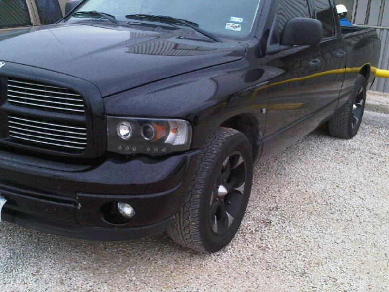

It happens after the engine is already started then once I turn the lights on including fog lights it dies check engine light comes on,then it starts right back up. I was driving on the freeway one day turned my lights on and it died on a busy freeway I had to hurry and get over to the shoulder. I did try and start it after the lights where already on and that seemed to work fine. Yesterday I was leaving work and got to the stop sign turned on my lights and it died again. It is happening more and more. No one seems to know what the problem is since it isn't throwing any codes. Thought about putting old lights back in and seeing if that helps. My heater coil is also plugged and my dash is cracked so this ought to be fun trying to get to that without ruining my whole dash. UGH UGH UGH. frustrated and I have new truck fever
Attached Thumbnails Truck Dies when lights are turned on-img00133-20091201-1117.jpg
