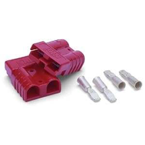

DON'T USE JUMPER CABLES WITH A WINCH! They are not thick enough and will generate heat. With prolonged use, at best you'll melt the cables, but more realistically, you'll fry solenoids.
I dunno who makes your winch, but Warn recommends 4 gauge only for runs under 6' for any of their vehicle size (6000 lbs +) winches and 2 gauge out to 24'.
Rolled 2 gauge is pretty affordable on either ebay or Amazon.com. For the quick connects, the Warn ones are about $60 a pop from them and their are some 100% clones of theirs from companies like Promark for about $35.
I opted for a set of twist lock quick connects from a local welding supply company. They are a little bigger and bulkier than the Warn type, but hold more secure and can be trimmed to work with anything from 6 gauge to 2/0 gauge. Also, a big plus was they were only $9.95 each set (two are needed, one set of the "+" wire and one for the "-" wire.
