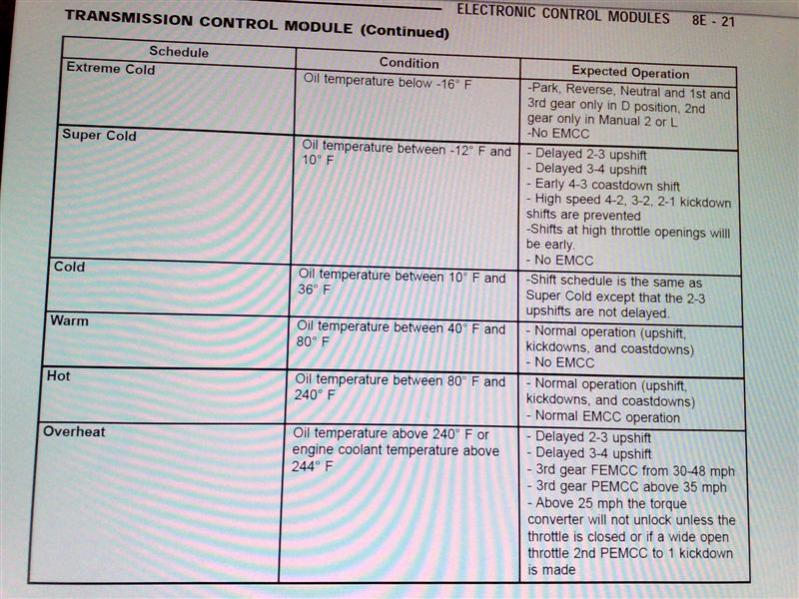

I have found this table in the manual telling me that "normal" or best temperature is 40 - 240 F.
the table say normal operation all the way up to 240 F... I guess that's why we use ATF +4 oil..
I will probably block that sensor anyway. cause then normal driving give me about 60-160 F.
and I wont worry about overheating when towing....
