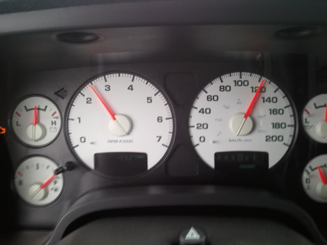

4.56's with 285 Tires she revs as you see doing 77 MPH US.
Can't find the other photo but at 2200 (Sweet Spot I believe I'm Running 65-70).
For the Money I'd recommend the 456's as these Trucks can only run so fast for so long anyhow and if towing is your thing and you don't own a Diesel this is the Gear Ratio to have IMO.
