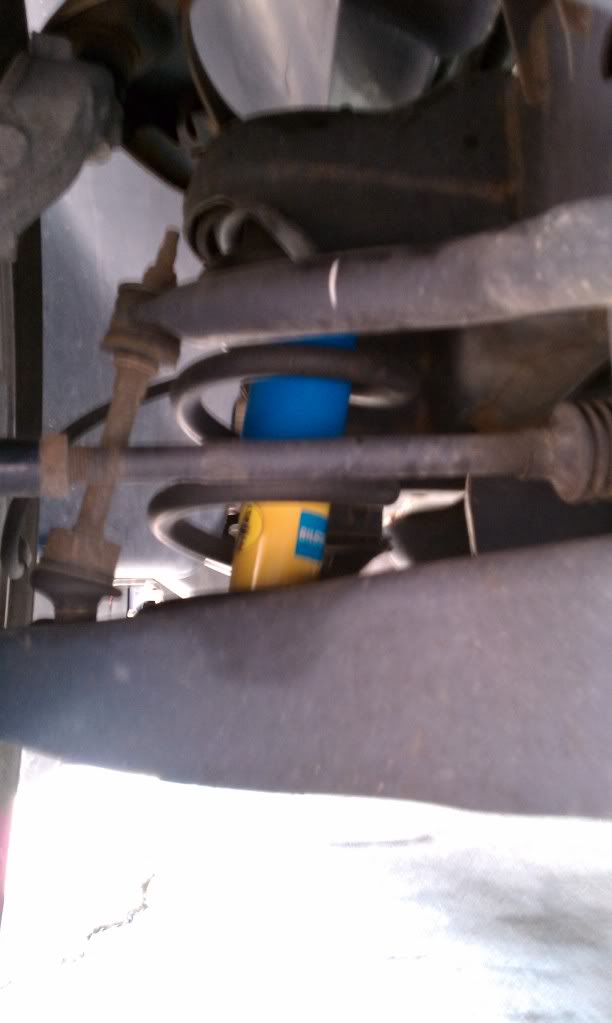

I like mine. They are much better than the stock shocks that would barely extend when manually compressed. The Bilsteins are much stiffer. The truck doesn't ride much stiffer, but the tires stay planted to the ground much better.
