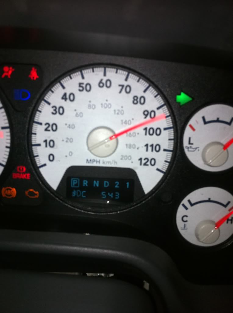

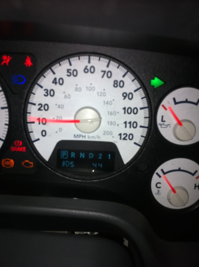

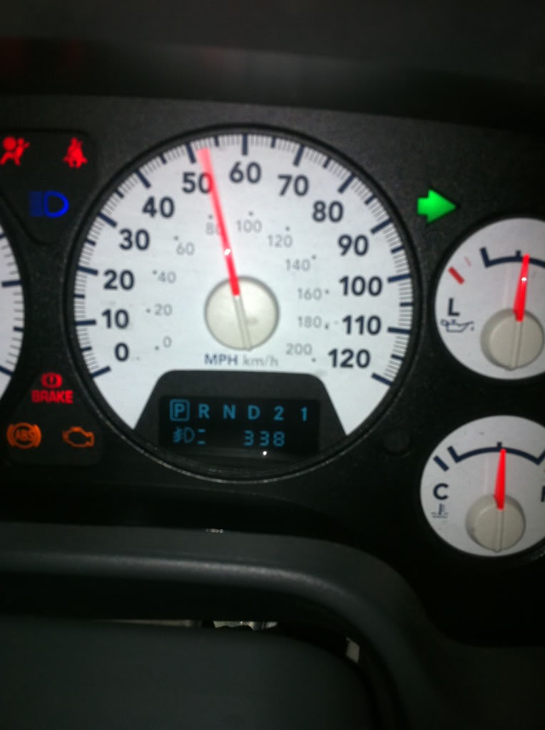

heres what pulls from my dash

ive heard a few people say they had to replace the TIPM.
Id like to know what the codes are, they dont look like the others ive had

I would look through the Service Manual and look in the IC section and see what it says about doing that IC check and what all info would be provided on the LCD screen. Something doesnt make sense there.
