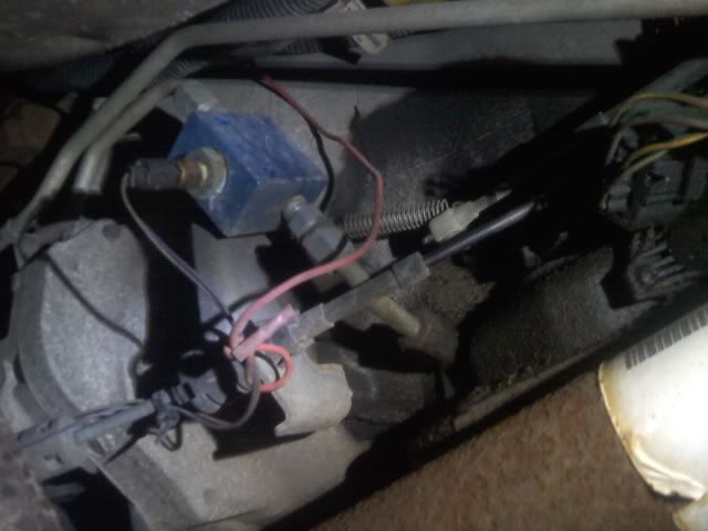

Old Feb 19, 2011 | 09:01 PM
rbrumm's Avatar
rbrumm
Joined: Mar 2008
Posts: 354
From: North Central Iowa
Here is where my manifold is on my 02
