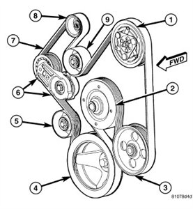

Hi all, Pulley #5 in the attached pic locked up on me. I think it is one of the idle pulleys, but i am not certain. Could someone please confirm what part it is and give some detail on replacement?
Im fairly sure i can replace this myself, but i have yet to do any kind of "pulley" work. I am replacing the belt too as it started to melt during the < 60sec the truck was running.
Any and all assistance is most appreciated!!

Here is a better pic (Tks weedahoe) this shot makes me think its the water pump.

Hi, had the same one go on me about 2 years ago..
Idler pulley, dont remember part number, but i bought mine at napa(only parts store where im at)
Also easy to replace, take belt off, unbolt old (14-15mm bolt dont remember which) bolt new one on, put belt back on.. Done.. 15 minutes
Just be lucky yours didnt melt on you like mine did, had to get towed home by a ford ..
BUt its a simple job.

Thanks Chris, I actually just got back from the parts store with 2 pulleys and a belt. figured I would replace them both. looks like the lower pulley just shredded somehow. Im actually surprised I didn't get stranded on the highway last night.
Thanks again for the info!!

Changing the idle pulleys is not hard. The just bolt on and off. In fact, you should already have it done by now.....
