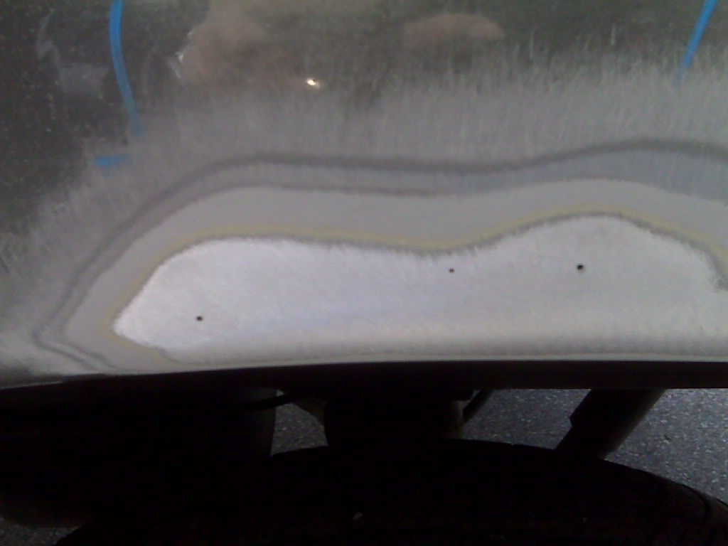

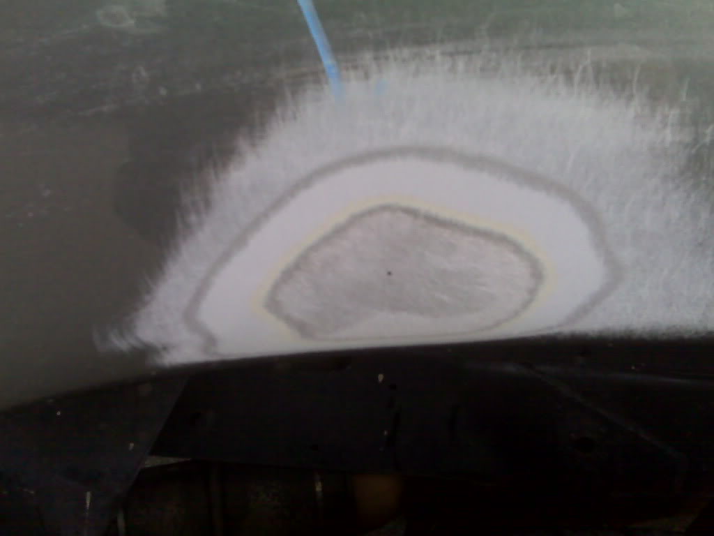

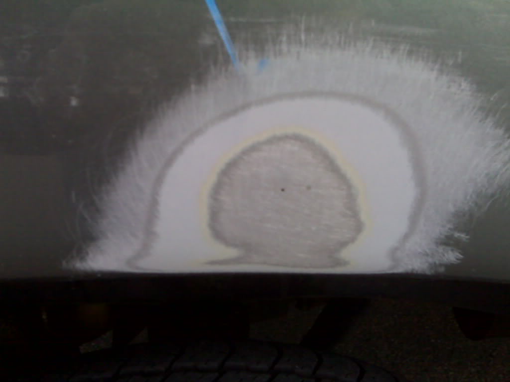

I had my box sides replaced under warranty for this issue. Best to pull the tail lights out then you can see ontop of the wheel wells. I could not get a photo but it was full of rust.
This is what's under the bubbles.
