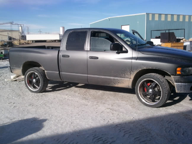

so i lowered the beast! the front is PERFECT. I got 2" drop shackles installed today, but the rear still needs to drop one more inch. how can i loose one more inch? here are some pics

don't know if they are made for the rams, but I used shackles & hangers on the rear of another truck to bring the rear down 4".

Yea i seen those before and i dont know if there are any out there for our rams. another thing too, our hangers are welded to the frame, not bolted. so i dont even know if i could change them.
Wait, what do they use to lower the rear 4" on a 2/4?? and i dont think i would want to remove one leaf or use clamps.

stay away from removing leafs or using overloads...remember the '80's mini craze with all the datsun/nissans/toyotas with the bouncy rear-ends?! talk about squirly in the curves.
you may have to go custom for just that 1" you seek...sucks, but if ya want it done right then don't half-ash it.
it was on my project fords that I used flip/c-notch for the f150 and a shackle/hanger kit for the v8 ranger. all parts were suspension techniques and bell tech

if you get a exhaust pipe bender you can remove the one inch of rear lift you are trying to. remember no heat must be a slow cold bend. i would start with about 1/4 inch in the middle even with the guide pin hole. it should take about 1/2 inch off off total high on each end (where mounts attach) this is an old school trick for lifting trucks with out paying out the ***. i have only seen it done on race cars but idk y it shouldnt work on street cars too. you must remember to use a very very slowly and NO HEAT WHAT SO EVER it will cause the spring to shatter and the small parts will in-bed in to the skin and can be lethal. im talking from and eye witness experance when the springs explode its like a frag grenade. i still have a peice in my leg and i was 3 bays down the shop!

why not a flip kit? or would that make it to low?
