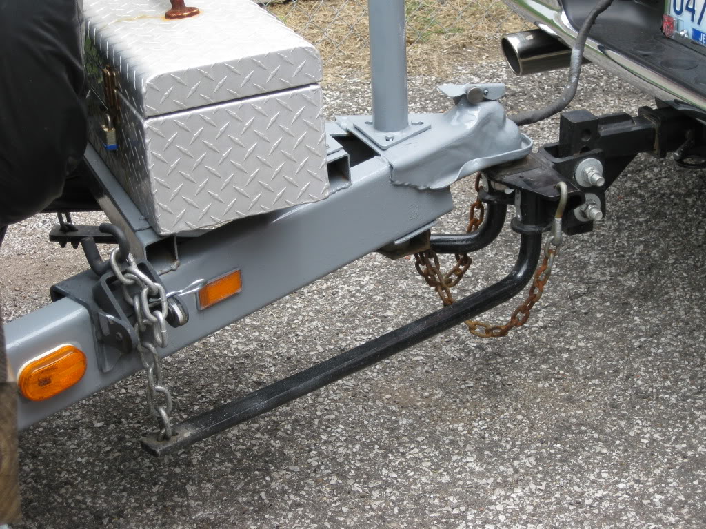

If you have the factory tow package, more than likely it has a 3.92 gear. You can go to www.dodge.com and go into the "for owners" section and use the "contact us" link. Email them your vin# and ask for a build sheet. The will email you a complete list of all options on your truck.
The proper term is weight distribution hitch. I have one and wouldn't tow without it. It eases the tongue weight and helps stabilize the truck/trailer.
If you are a 2wd like me, your max towing cap. is about 8800lbs.
