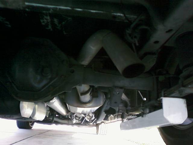

I pretty much went 'the best of both worlds' (at least for me)...I did true duals all the way to a 22" magnaflow (3" dual in/3.5" single out) and dumped it after axle. I wanted performance, not loud. I wanted to be stealthy, just a little louder then stock. I wanted flow, but not lose low-end (my 60 ft and 1/8th times prove that)...AND, if I wanted loud, just open the cutouts...
http://www.youtube.com/watch?v=DA_MFYFOPCI

dumping it will lose the drone (unless you are a fan of showing your pipes), and in my 50's now, I want it very quiet in the cab, listen to my radio without crankin it up...and then when the urge comes out, open the cutouts. As for emissions, find a smog shop that just cares about the sniffer test. i didn't remove my cutouts and just clamped on a tip for smog test. Also, when I had the tip on, it droned pretty loud in the cab as opposed to no drone when I took it off..
