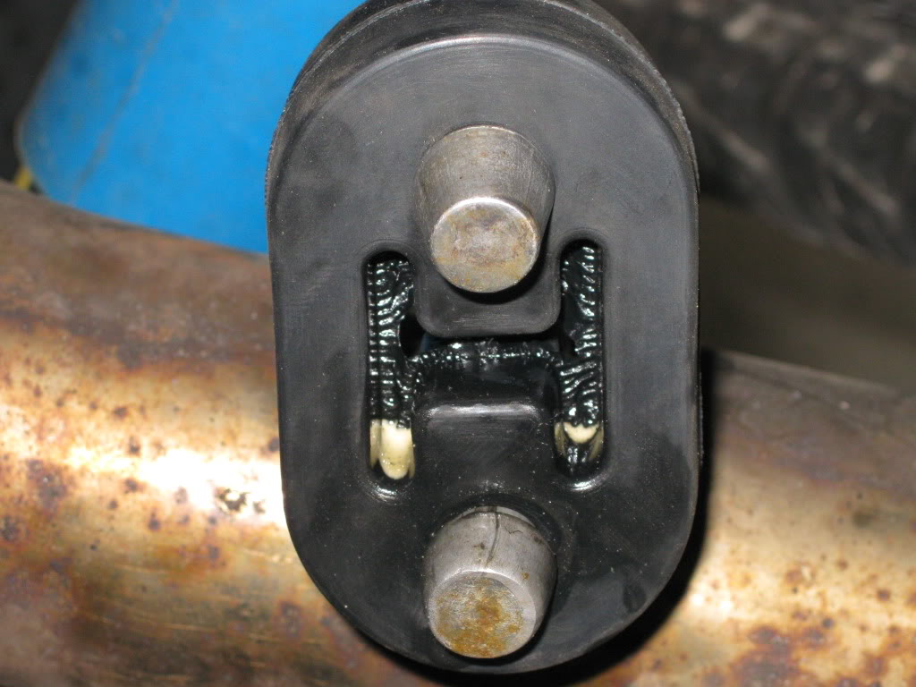

Myself and others have noticed that the excellent Mahnaflow cat-backs are top notch except for the cheesy driverside tailpipe hanger. It is way too soft and allows the driverside tailpipe to bounce arouns some while the passengerside is nice and solid.
I found a cheap fix for this. I went to AutoZone and picked up a new rubber hanger in the exhaust aisle. It is much thicker than the one that comes with the kit and holds the pipe in place much better. Best of all it was under $5

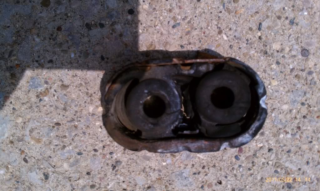

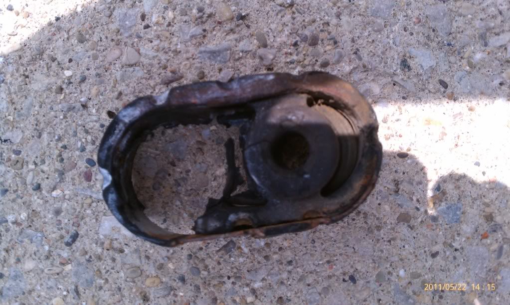

Do you have a picture of the cheesy tailpipe hanger? I might have an even more simple solution like running a ziptie around the outer perimeter. That would make the rubber stiff as a board up/down but allow some side-side movement.
Old May 22, 2011 | 02:12 PM
lxman1's Avatar
lxman1
Site Moderator
Posts: 9,657
Likes: 24
From: Louisville, Ky
It has a real thin outer wall. Good for isolation, bad for keeping the pipe still.
