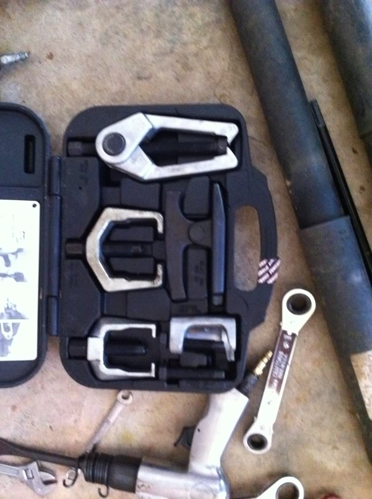

Old Jun 9, 2011 | 06:53 AM
Matt99's Avatar
Matt99
Posts: 4,210
From: Shreveport, LA
Ive had good luck with tie rod pullers. the largest one
