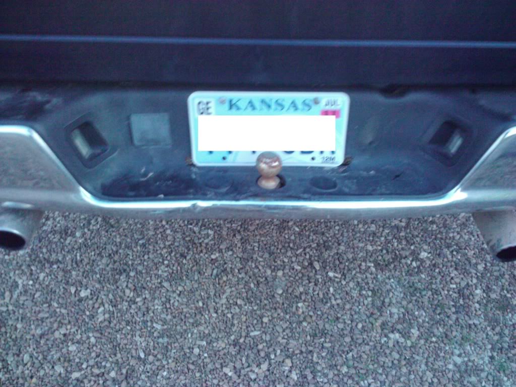

now i'm thoroughly confused. so no more words from me, heres what there is on the truck now
where it connects to the frame:
ball coming through the bumper
Old Jun 6, 2011 | 05:36 PM
Blacksport's Avatar
Blacksport
Joined: Aug 2008
Posts: 537
From: Alberta, Canada
That looks like it's part of the bumper. You'll need at least a class III hitch as stated before.
Old Jun 6, 2011 | 06:35 PM
xjfever's Avatar
xjfever
Joined: May 2011
Posts: 121
From: North, Ga.
http://www.etrailer.com/Trailer-Hitc...eid=2004300058 This is what you need. It is rated for 600lbs tongue weight and 6000 lbs trailer weight.
