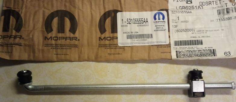

Old Nov 28, 2011 | 07:54 PM
gheegrose's Avatar
gheegrose
Posts: 39
I knew I wouldn't have all the parts I needed. Looks like I have to buy the set screw or whatever goes into the adjustment clamp.
In case this helps anyone...here are some pics of what I got.

Old Nov 28, 2011 | 08:58 PM
HammerZ71's Avatar
HammerZ71
Posts: 24,686
I've got about a foot long strand of 80 lb. test PowerPro braided fishing line tied to mine and the frame now, so maybe if it falls out again, the line will keep me from losing it altogether...
