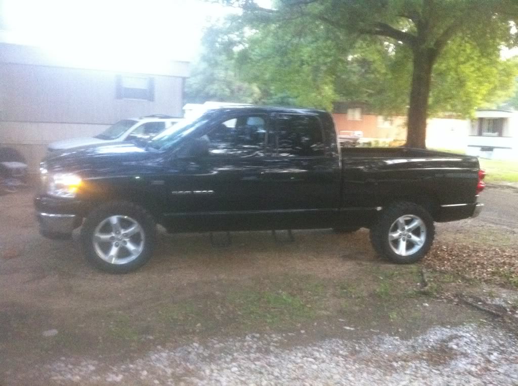

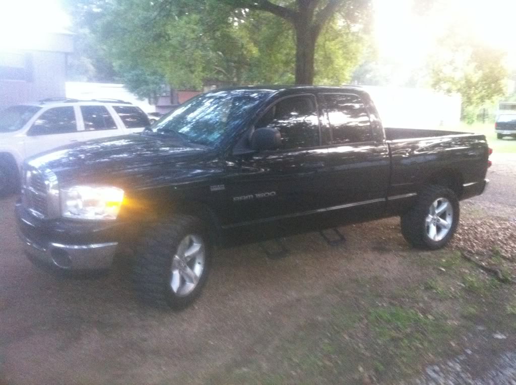

Well they fit!!!!!!! I tried them with no spacers and there was a lil rub o. The upper control arm , so i wend and bought some 5/16 th spacers and slaped them on and man this thing looks mean with nittos on it ill post some pic tom .... Thanks for the responce

Not much sidewall there for serious off-roadin', but they look real nice...

It has more than you think, im gonna level the front and she will look baddddd
