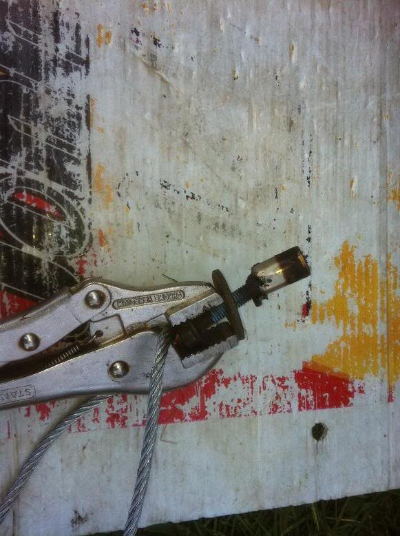

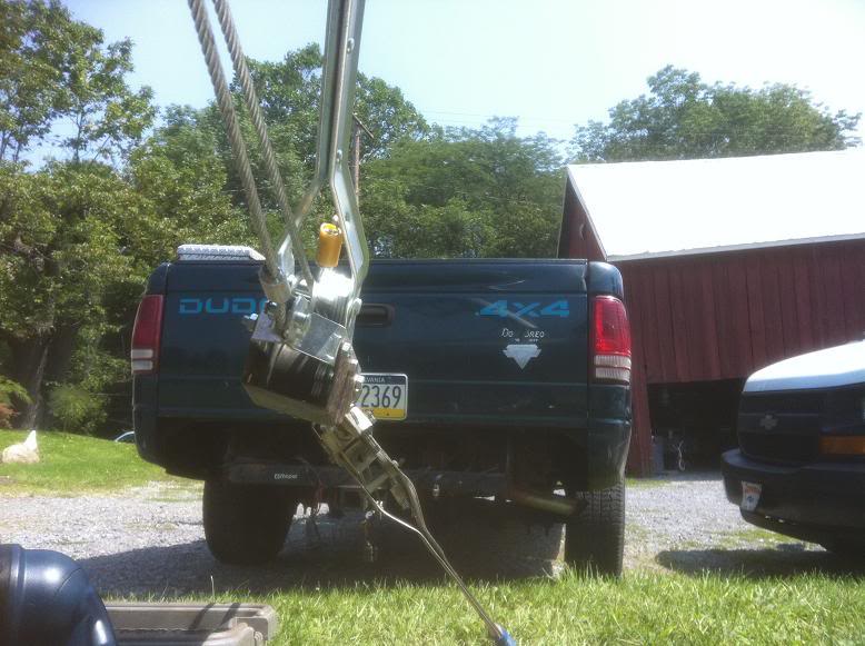

Though the come along was over the top. Broke mine today after installing new injectors. Figured how hard could it be. Just 1 bolt and a disconnect clip.
I guess every day you learn something. I pulled out a dermal type tool and used a rotozip bit. It got a bit smoky but I did get rid of all the plastic. Then I sort of slit the side of the metal. I managed to bend the metal in and was able to get needle nose pliers on the metal and just pulled the metal with the magnet out.

Originally Posted by dirtydog
wow, that's insane. At first I was like wtf is that wire doing in there and then holy crap he used a cumalong...lmao.
I figured it had to be rust stopping you and those concrete screws are tougher than sh*t.
Glad to see you atleast got the letal bulk part of it out. That piece will likely just sit at the bottom of the pan for it's life. I doubt you would have any problems unless it makes it's way to the drain hole and super slows the oil from coming out, then you'll need to push it in with a screw driver to let the oil out..haha unless of course you can get needle nose pliers in there to pull it out?

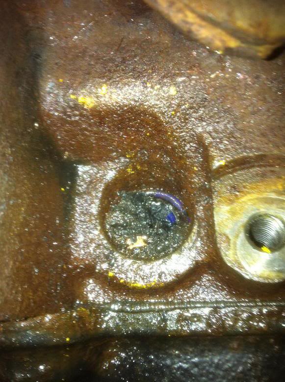

Well, It took a good 8 hours, but finally, it's (mostly) out. I used 3 different sized screws, finally on the 3rd I pulled the magnet out, but the plastic stayed in. It was loose, but there was a lip of rust that I couldn't pull it over, I tried to chisel and chip it apart to get it out but eventually gave up and just pushed it in. I sanded and filed for a good hour until the new sensor finally, very snugly, fit in. ... Sadly, the sensor was not my problem.....
Just reviving an old thread here to share my experiences. Same thing, 4.7L V8, attempting to remove the Crank sensor resulted in it breaking off inside the block. Using tips from this thread, I drilled out a 3/16 hole in the center of the carcass, then JB Welded a tap-con concrete screw. After letting it set for a few hours and curing, I sprayed some PB Blaster around the edge, let that sit until the next day. Then I used a $25 Harbor Freight slide hammer to work at it. After a hand full of whacks with the hammer, I could see the sensor was slowly being pulled out, so I kept at it. Within a minute or two I had the sensor out. Then I used a fine grit Dremel sanding drum to clean up the corrosion in the fitting, used a little gear oil to lube the o-ring, and replaced the sensor. Time from starting with the slide hammer to tightening down the new sensor was less than 10 mins.

Same EXACT same problem, same as pictures and everything. Even BROKE the come along I used. Finally got it to your last picture with a bunch of heat, installing the bolt and using it as the fulcrum to get my carpenter hammer's claws under the cement screw and finally working it out. Could NOT get that last part/photo out and pushed it into the block. Did you leave it there or remove the pan and get it out? What a total PITA.
