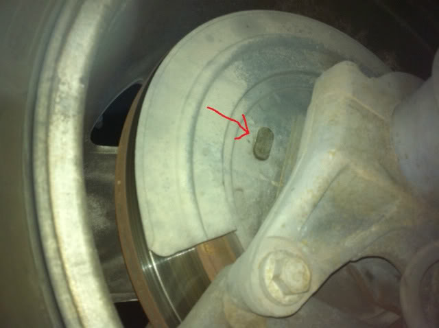

Hey a picture would be great of this star adjuster! Sorry to jack your thread Badhazard, but I tried to get my rear rotors off yesterday and they are frozen up big time. Searched and searched for an actual picture of the adjuster for the emergency brake but could not find anything.

give me a few minutes and I'll post a pic, I just went outside and on my passenger wheel the adjuster wheel is on the bottom side of the axle. there might be a rectangular rubber plug over the hole.

i think i found it, mines on the top on pass and bottom on driver. There is a rubber thing over it. I pried hard and it didnt really budge. Does it need to be lifted to do it?

Okay, well between my iPhone acting up and photobucket not working with me, here's a picture, but it's not rotated correctly LOL
The Left side of the picture is towards the ground. The arrow points to the rubber plug that you pry out and shine a flashlight in to see the sprocket wheel. This is on the passenger wheel so it's below the axle, the drivers side should be above the axle.
