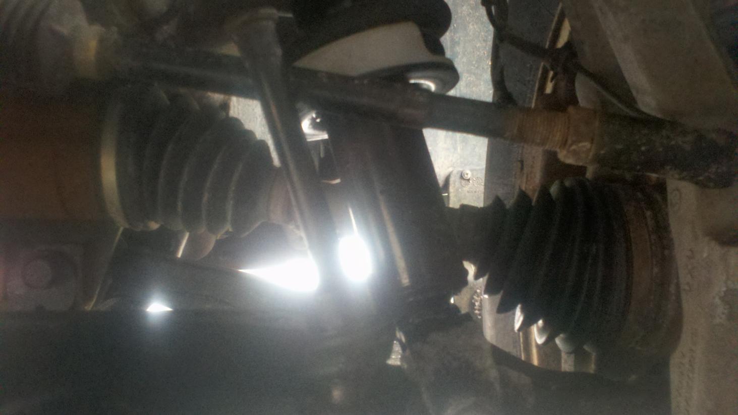

Hi everyone,new here. I just installed new monroe struts in my 2006 1500 4x4 with the hell bent steel 2 inch level kit. My question is now the front sits about 1.5 inches higher than the rear and there is a noticeable vibration in front when accelerating in 4wd. Once you are at speed and are just cruising there is no vibration. I am trying to decide if I should lift the rear now to make it level or just take out the level kit and return it? I searched this topic and seems hit or miss. Here is a pic of the front cv joint angle because I am assuming that is where the vibration is coming from. Looking to see what others have done with this or are you just dealing with the vibration? Thanks

did you have an alignment done after installing the parts? Thats the first thing to do after changing anything geometry wise, I would also even look into re balancing the tires for piece of mind. How are the differences in tire diameter also in relation to the rear? And for what its worth noting if your doing this on dry pavement it could amplify the problem if you have a slight difference in tire size.

I have got a vibration in acceleration in 4x4 after installing my 2" Hell bent leveling kit as well. (I'm not positive it started immediately after the install because I didn't use 4x4 for some time after) I have not had a chance to chase exactly where its coming from yet, but my cv's don't look to be on too sharp of an angle, but maybe it is.

Thanks for the replies. The tires are new about 500 miles ago and yes a alingment was done after install. I guess my real question is has there been any long term damage from this issue and has anyone also ran into the front now sits higher than rear?
