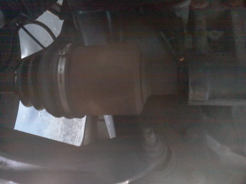

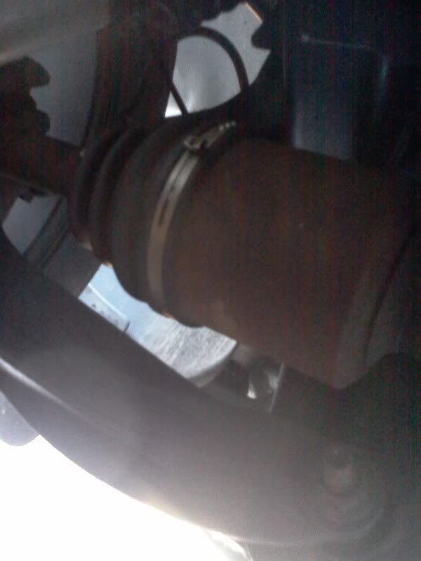

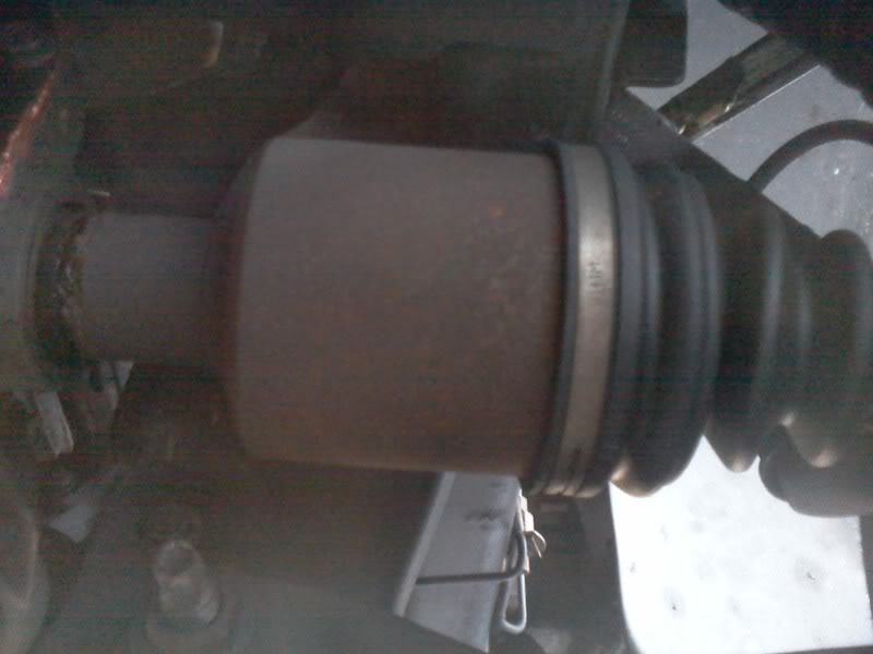

Take a pic and post it. Also take a pic of the CVs, boots and especially make sure your pic gets the angle of the CV shafts. A front level kit, if excessive will put the CVs at a poor angle and weaken them considerably, also it stretches the boots making them prone to tearing. I suspect this may be the case...

sorry for the crappy pix my phone sucks and im at work

The middle two pix show the gooey stuff i was talking about and the boots on the axels look fine no rips or anything

Your angles are bone stock, which is good. Looks like the inner seal went...
