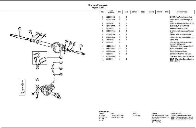

Hey, three night ago the windimg noise, which I thought was my hub assy became so bad I could no longer ignore it. Turns out the driver's side drive axle was coming off the output shaft on the front differential. Needless to say the splines are spanked on both the axle and the output shaft coming out of the front case. I ordered a new axle, but searching under driver's side output shaft I can't fint the splined shaft I need any where. Any advice on where to look or what it's called? Thanks!

Junkyard or dealer. I believe it is called the inner axle shaft. I just bought one for the right side, but ended up not needing it. Too bad or I could sell you that one.
Edit: Part catalog calls it an Intermediate Shaft. Using online junkyard searches, you'll look for a front axle, then specify inner and the side. I believe the part # is 52069887AB if you want to order at that site or get at dealer.

Well I finally found the damn thing. It's called an "intermediate" shaft( #7 on the diagram). I got it on ebay new for $45.00 and went to Napa and got the seal, bearing, and all Amsoil to replace the fluid in my front diff and transfer case. I'll post my results as soon as the axle comes in.
