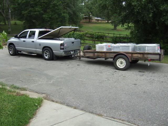

I dunno why it's taking so long for you fan to kick on, mine turns on at about 178* like clockwork and yeah, I've pulled 7000+ lbs. of tractor on a big trailer and the efan consistently keeps it cooler than the clutch fan did...
Same here, more or less. I have mine set at ~210 with a 203 'stat. Even pulling this through traffic, it did its job:
That's almost 12,000# GCVW
