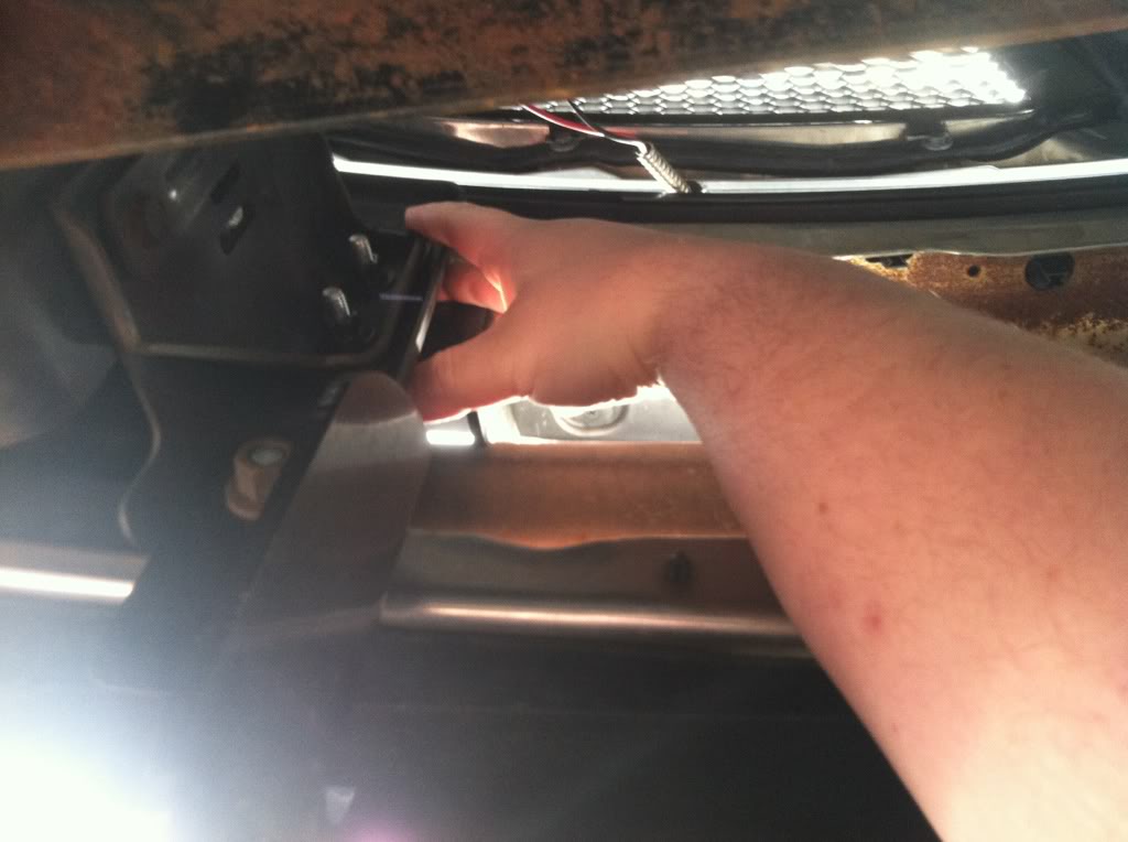

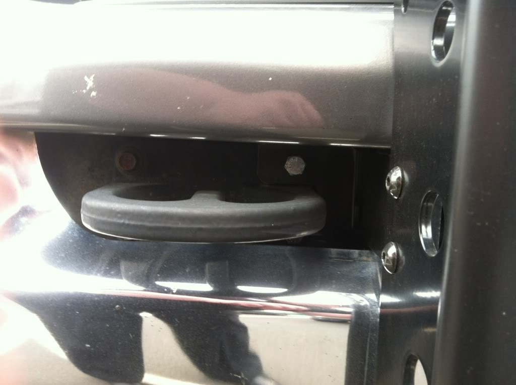

The mounting holes for the tow hook should be there. Take off the plastic filler panel on the front bumper(real bitch to do without proper tool) you should see them. You might have to get a few spacers to make up for the thickness of the hooks but there should be enough adjustability built in to the mounting hardware for trucks without the hooks. I'll take a pick from the underside of my truck with my hand on the mount location so you can know where to look.

My truck is a 2004 2500 I think they made a few changes for the 2007. Name:  77125b71.jpg
Size:  62.8 KBfront view of tow hook with plastic out of the way
Size:  63.5 KB underside view(not sure if it helps much because of my model year) but you should see the mounting holes if you have them

I installed a Warn Grill guard on an '02 and drilled new holes. Prepare to go through a couple of bits if you do it thataway...
