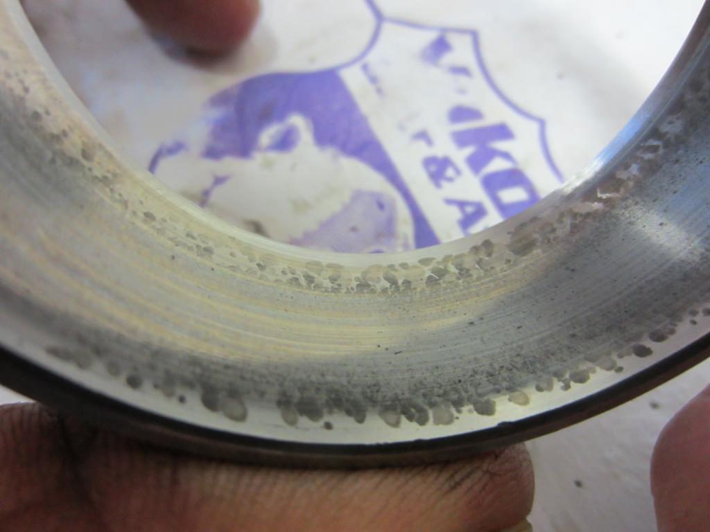

Heres a pic of a bad pinion bearing race I just took out of a rear end I rebuilt.
