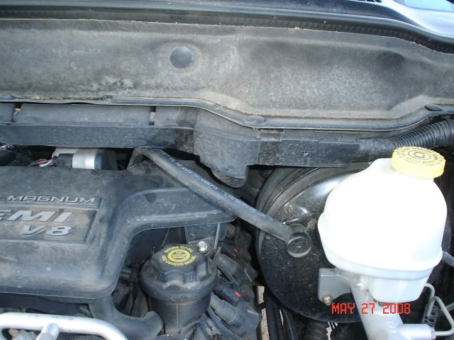

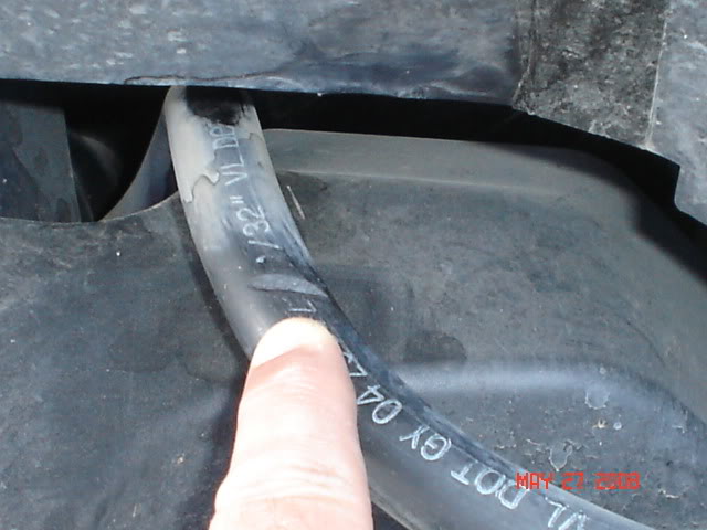

It runs on vacuum, look for a vacuum leak up front. I fixed one for a young lady a couple of years ago and found a pinched vacuum hose with a cut in it. Same symptoms as yours. I have a pic of hers, use it as a guide as to where to start lookin'...

Thanks, I read that earlier when I searched. If that is the problem, would that actually cause the cruise light itself to turn off on the dash?

Well today I checked that vacuum line that was shown earlier and mine was fine. Mine actually runs next to the hemi hat, not on top like the pic. I also looked at the front sensor on the hub, disconnected it at the connecter and pulled it out of the hub. It looked fine. I put everything back together and started it up. I ran it for 30 minutes at idle and the light stayed on the whole time. As soon as I put the truck in reverse and started to move, the light went out. This time, the light will not turn back untill you come to a full stop, then it will allow you to turn it back on. I still need to try and find where the cruise is located and see if the vacuum lines are fine there. I am also wondering if the sensor is bad like Weed said earlier.
