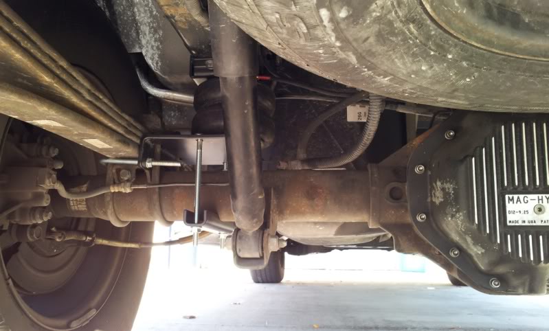

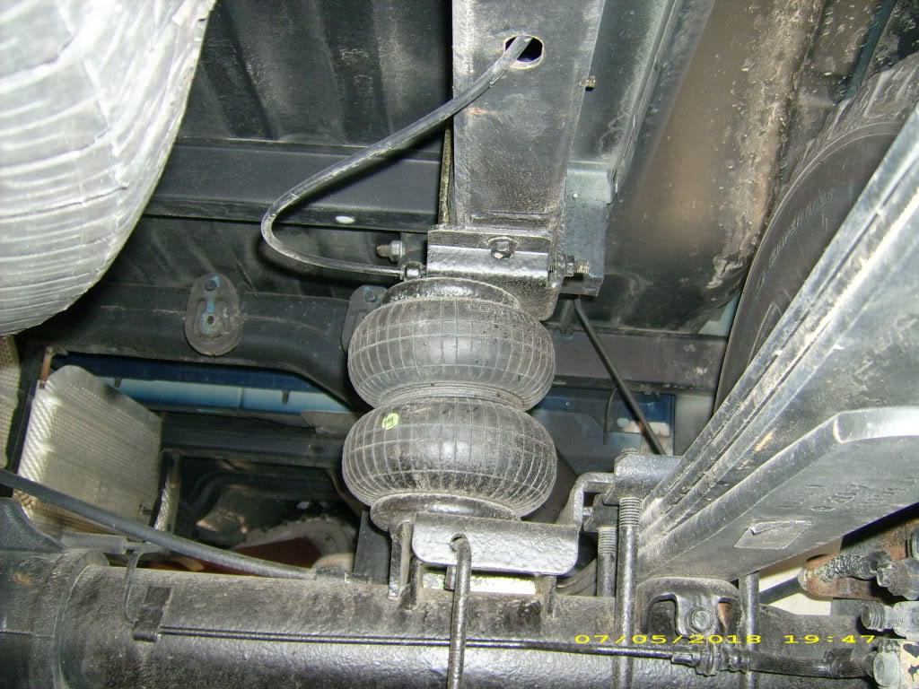

Mine are similar and are being helped by air bags. Aside of the rust, looks okay to me.

Also, yours are lifted so the added stress probably contributed to the bend you see in your springs.

The OL spring is suppose to be straight, not bent downward at all. The upper springs should have an even curve upwards and I see in the middle it bends the opposite way.
Hessain, your springs are wiped. You have either overloaded your bed with weight or had too much tongue weight pulling a trailer.
I dont see how putting the same size block as the axle under the spring effects anything but the ride height. The same amount of weight is still above the springs either way.
arienike, you have overloaded your truck as well. Your OL springs are bent downwards as well, but your upper springs are still in good shape. The airbags may have saved them just in time.

Interesting. I don't remember ever seeing my OL springs flat. Maybe they were flat at one time
