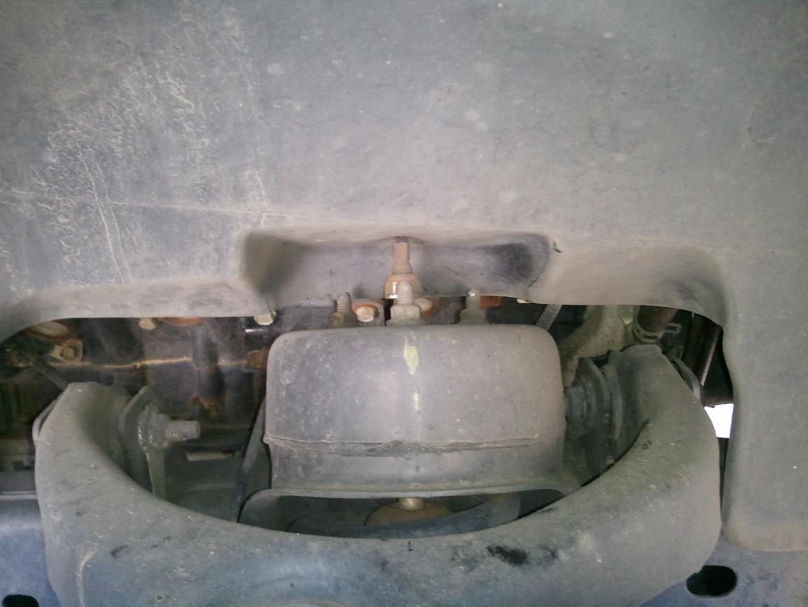

I had a friend help me out yesterday and it looks as though the front passanger suspension isn't working properly. The shaft that runs through the middle of the coil (sway bar) isn't locked into the cup on top of the coil. Its moving up and down when shaking the car. I've included a picture of what it looks like parked and you can easily see the rod sticking up higher than it should be.

Shock absorber needs replaced would be my guess since it ate the upper bushings.

Agreed, looks like its time for shocks.
