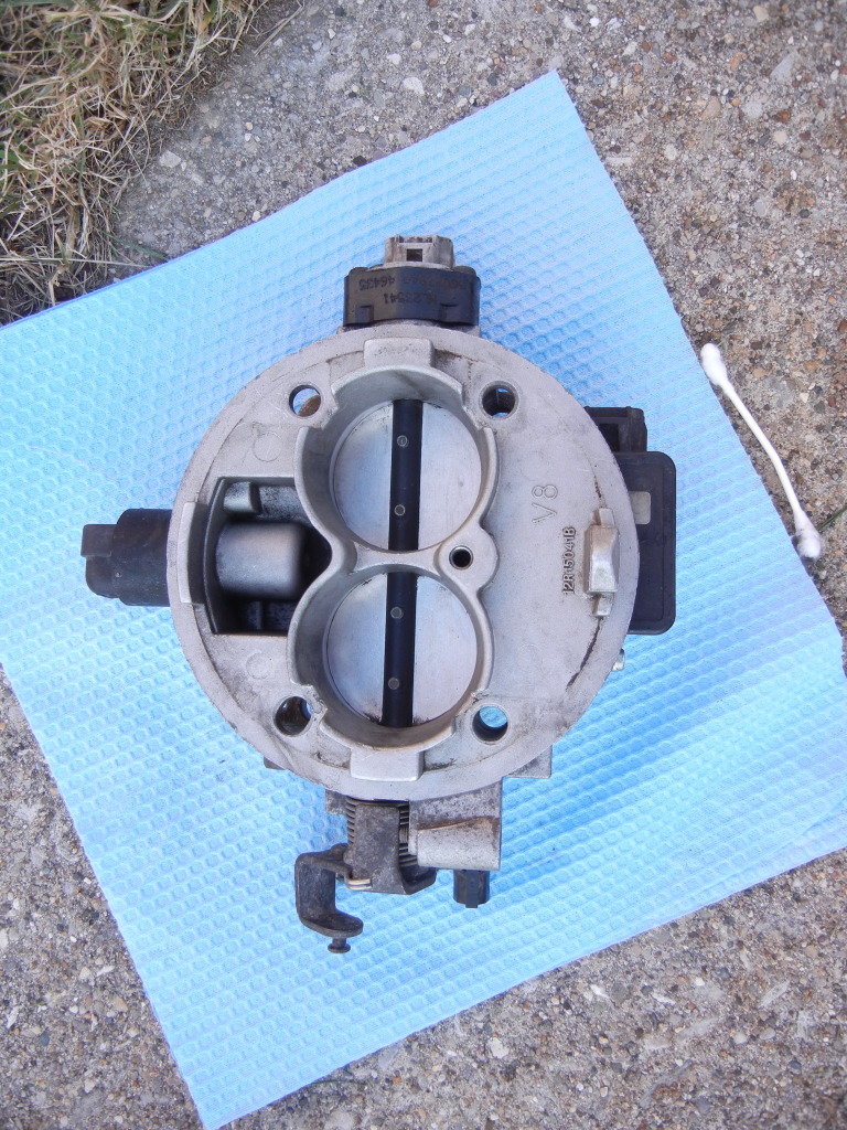

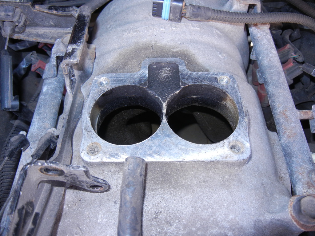

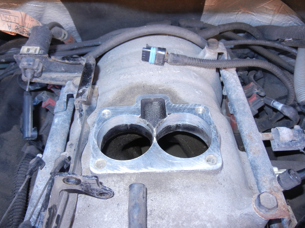

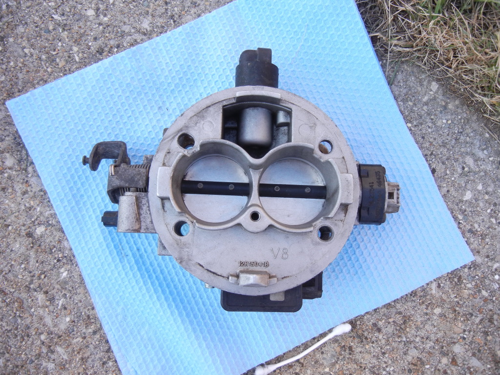

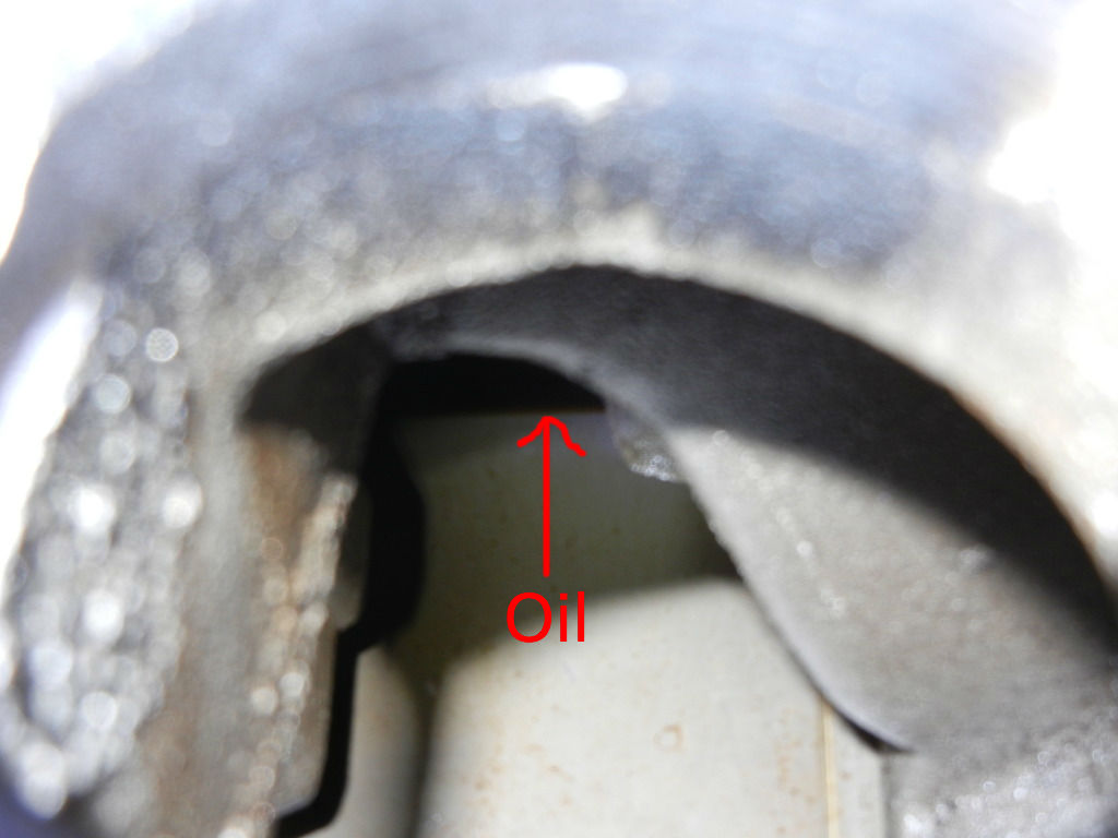

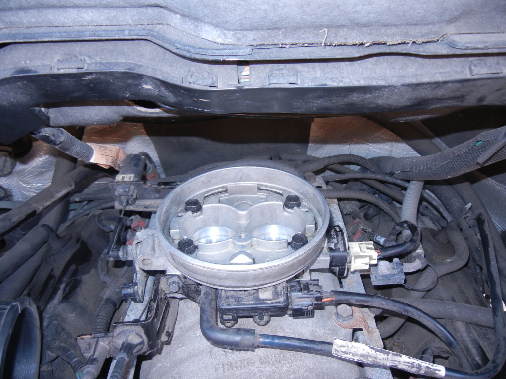

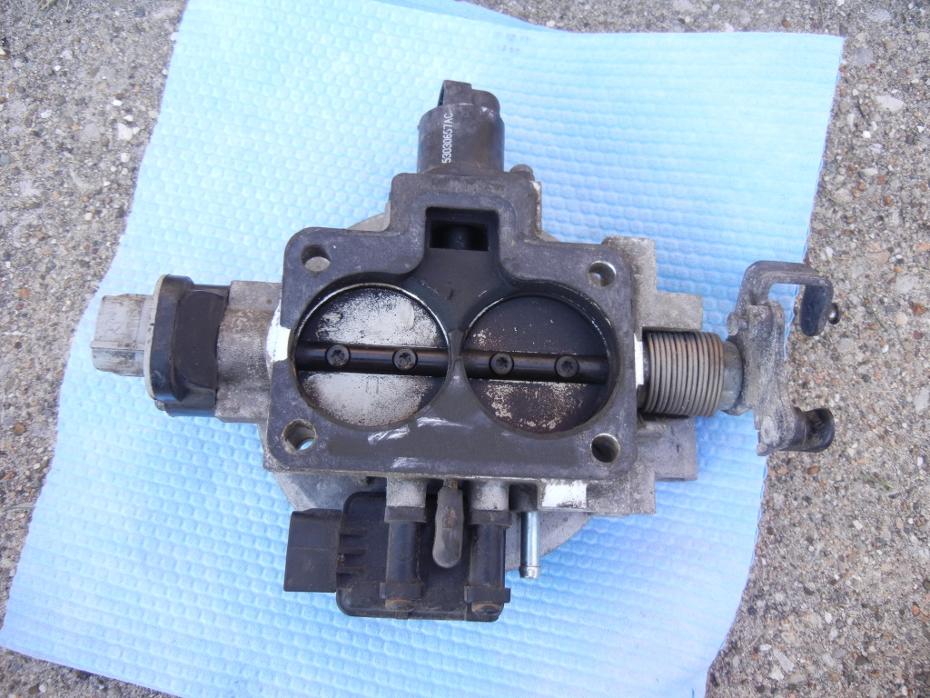

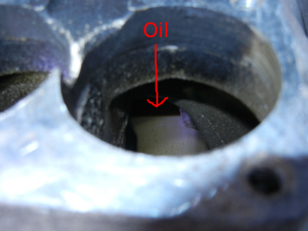

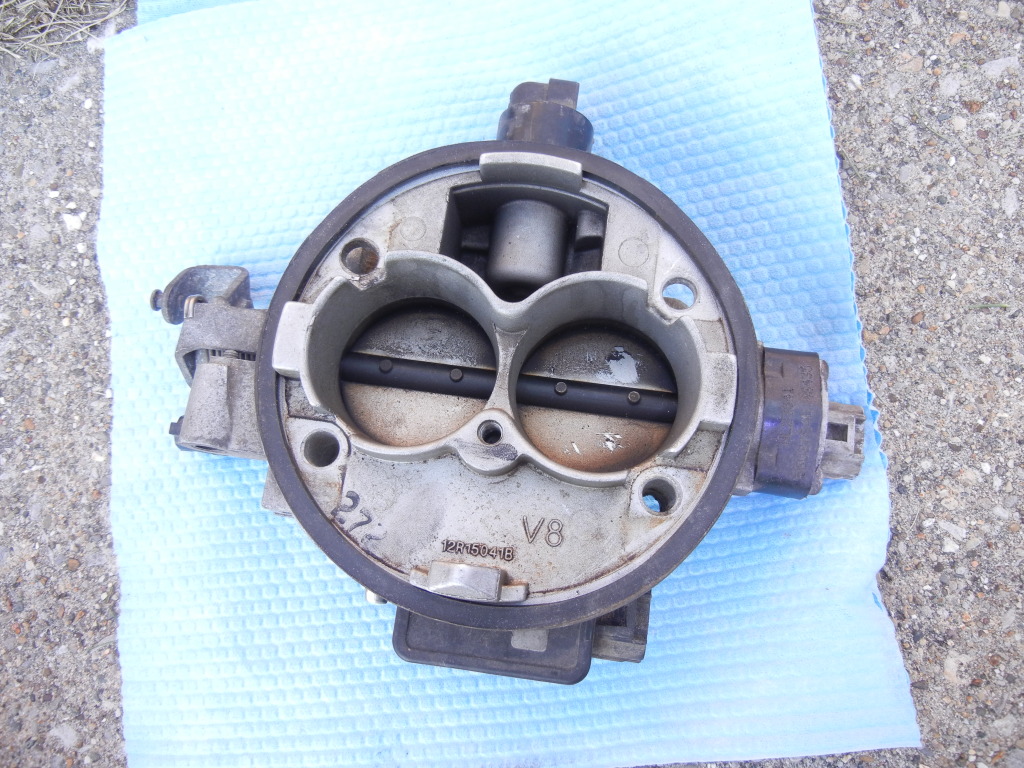

Okay so today I took off the throttle body to clean it and it was filthy! The gasket was cracked too so I don't think its ever been cleaned. Anyway I looked down in the intake to get a better look and I did see a little pooling of oil. It was up against the back corner due to the slight angle of the engine. That's why I couldn't see it before. So in the near future I will be doing the plenum fix lol. Probably not til the end of the Summer when I can get back to my dads shop to have more room and tools. I took some picks throughout the cleaning:
Before:
After:
Pooled Oil, a little hard to see it in the pictures:
