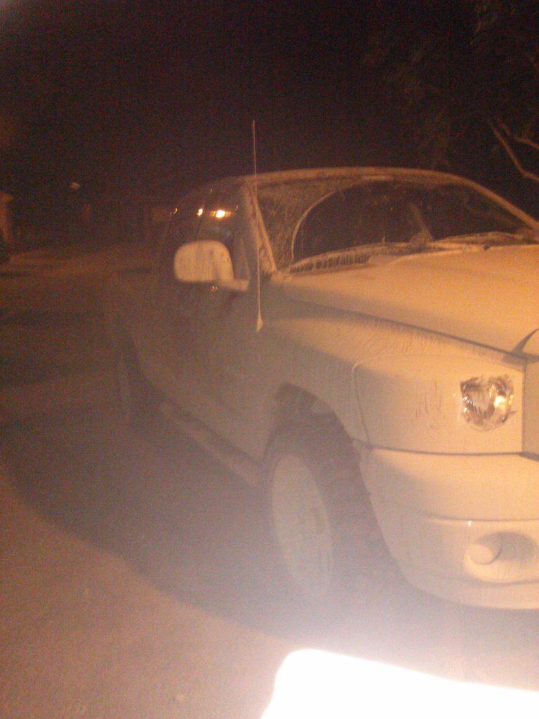

Before and after pics and we also completely lost the drivers side fog light .Both pics are from tonight
