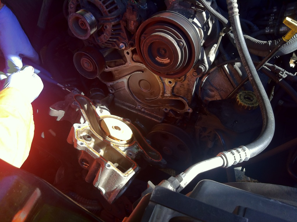

Old pump getting removed.
And another.....

Obvisuly we have the same OEM pump, did it not just seem cheap internally??
I scrapped mine lol
