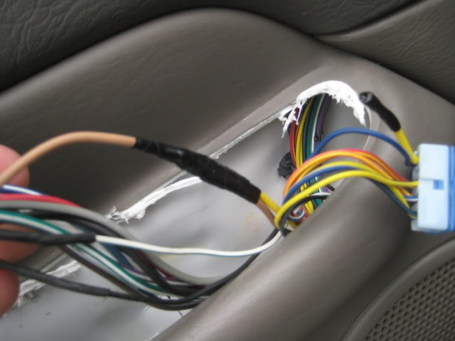

kx250frider617's Avatar
kx250frider617
Posts: 1,562
This is how you by-pass the window lock. Cut the big yellow wire and spice it into the big brown wire. This is for my 03', Im pretty sure all the switches use the same wire colors but don't quote me on that.

Old Dec 11, 2012 | 03:21 PM
kx250frider617
Posts: 1,562
The brown wire runs power to one plug and the bigger yellow wire is the window lock lead from the other plug. Basically, the brown wire is constant ground I believe, the window lock switch cuts the ground to all the other switches. Therefore, if you solder them together, you by-pass the window lock.
