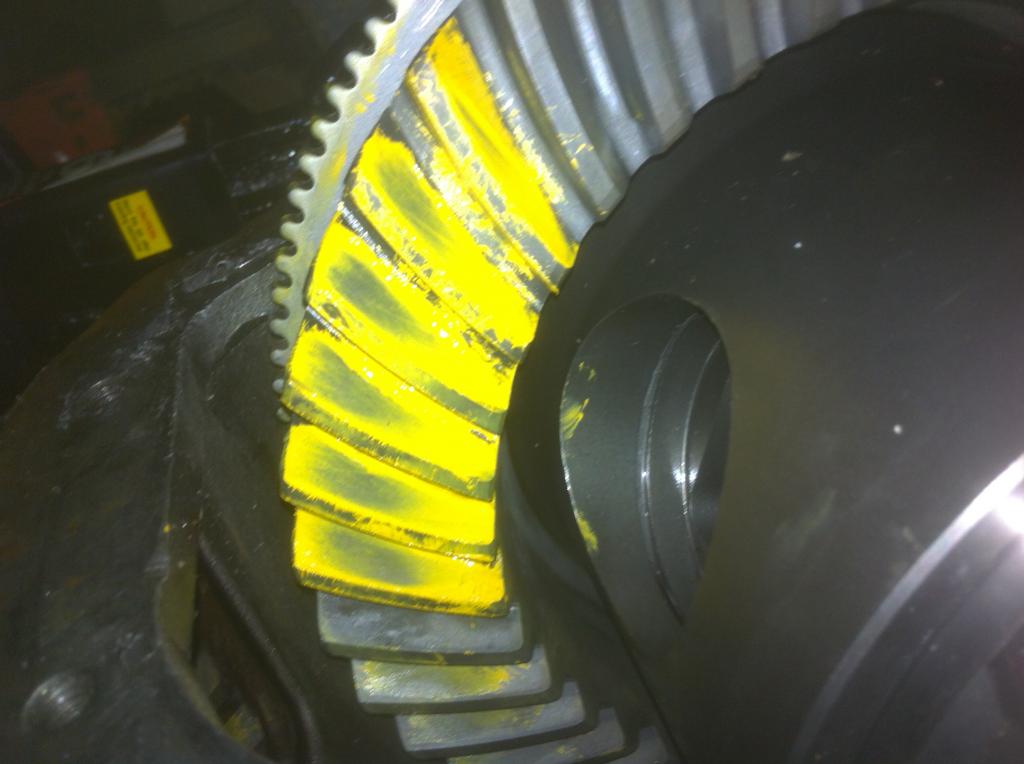

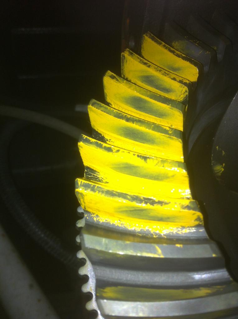

Since my Detroit TrueTrac came apart and destroyed my rear, I finally got some time to rebuild it. After enough research, it wasn't so bad. I used the Ratech solid spacer instead of the crush sleeve, so it was a little tricky to get the preload right, but I have it at 24in lbs so I'm good there.
The pattern is a little off, but it doesn't make any noise. I think I should try a smaller pinion shim but since it doesn't make noise, I think I'll roll with it for a while.
Drive Side a little towards toe side

Coast Side
heeled out. It doesn't look quite this bad in person
