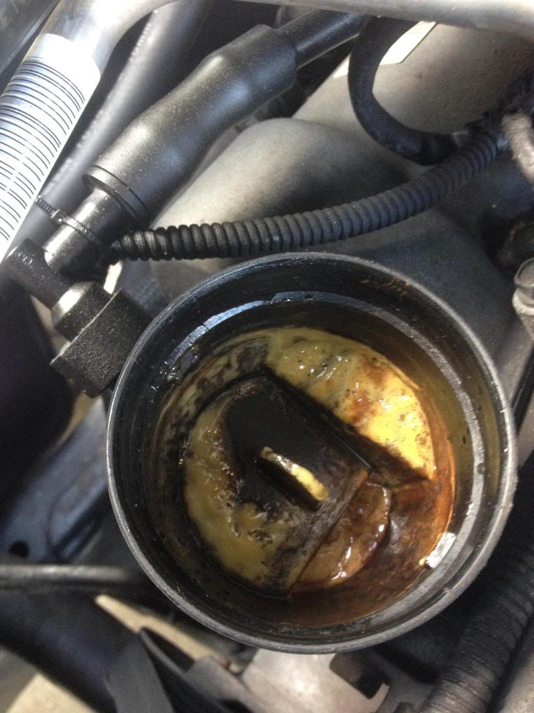

my friend was too busy to look at truck yesterday so i didnt get to go. but what i just noticed is if i take the heat control and turn the know half way in between warm and cold its actually decently warm. why could this be? i was thinking the blend door was installed wrong but i dont see how that would be possible? also i always smell coolant after i drive the truck i have a bad feeling about a headgasket issue so i took the oil fill cap off and there is all kinds of white jelly crap on the bottom of the cap. a couple of mechanic friends said thats common in the winter especially with chryslers so idk
That's not good. Sounds like a headgasket problem for sure.
Do an oil change, but drain the oil into an open pan (make sure it can hold enough liquid so you don't make a mess) and check for coolant on the surface of the oil in the pan.
If you have coolant in there then you likely have a headgasket problem... as for the heat issue, if you smell coolant in the car then you likely have a bad heater core or the lines to/from the core (or the core itself) are leaking coolant into the cabin. Even in small amounts you will smell it.
Have a leakdown test done to confirm the headgasket as the issue.

i dont smell heat inside its on the outside when i get out. heater core is brand new i just did it a few weeks ago as are all the blend doors, water pump, radiator, rad cap, tstat, clutch fan and serp belt. i have been told by several mechanics now that chryslers always get this white jelly in the oil cap\fill. here are a couple pics

well good news finally. i was told all that crap in the oil fill is normal for chryslers espec in the winter time and they do not think the head gasket is bad. the good new is i pulled the arm off my actuator that controls hot to cold and bam heat is blazing on both sides, so i must have put one of the blend doors in upside down(idk how i even managed to do that)!! so i left just about everything ripped apart just so the truck was driveable so it should be fairly quick to get it all back out and switch the door\s around.

That milky crud is not "normal" it is a sign that you're leaking coolant and burning it in the crankcase/block somewhere.... the result is that milky crap once it condenses back into a liquid.
I had it on a Subaru, and let me tell you it was definitely a head gasket...
