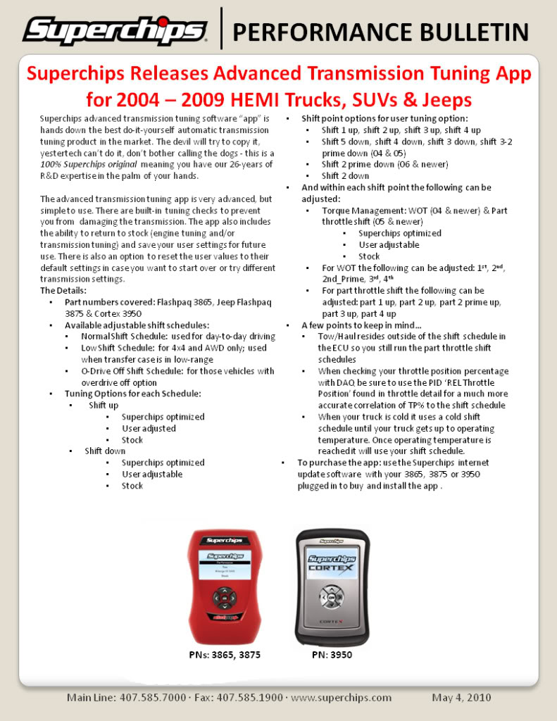

Pretty sure you have to buy the trans tune regardless, and it's per vehicle, the cortex only offers more vehicle support, so you can tune your Ram HD diesel, and remove it and tune your Hemi challenger for the weekend.
Once you tune the truck and the VIN is stored in the programmer, you come back in and plug the tuner into the PC and it will verify your vehicle is supported, and then the trans tune is available for purchase through the software.
I didn't buy the trans tune, and found the tuned transmission much better than stock, I didn't have the desire to customize beyond that for now. I'm running the 3865.
