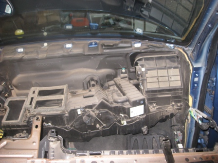

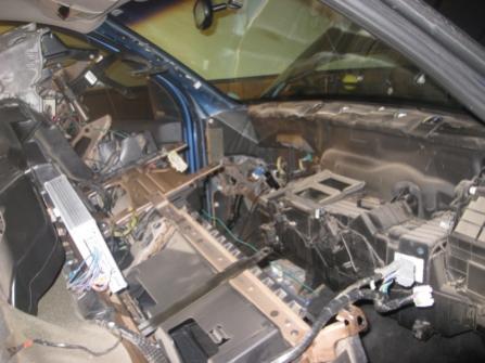

checking the vent doors is a pain, but relitively easy if you have ever worked on a vehicle before. here are a couple of pics of your airbox. The blend doors controled by the motor in the center of the box in the second picture. There are two doors, one for pass. on for driver. In vehicles without dual climate control the doors are connected and function together. It is not unusual for the plastic connecting the two doors to break, causing the symptoms you are describing. Best of luck.
