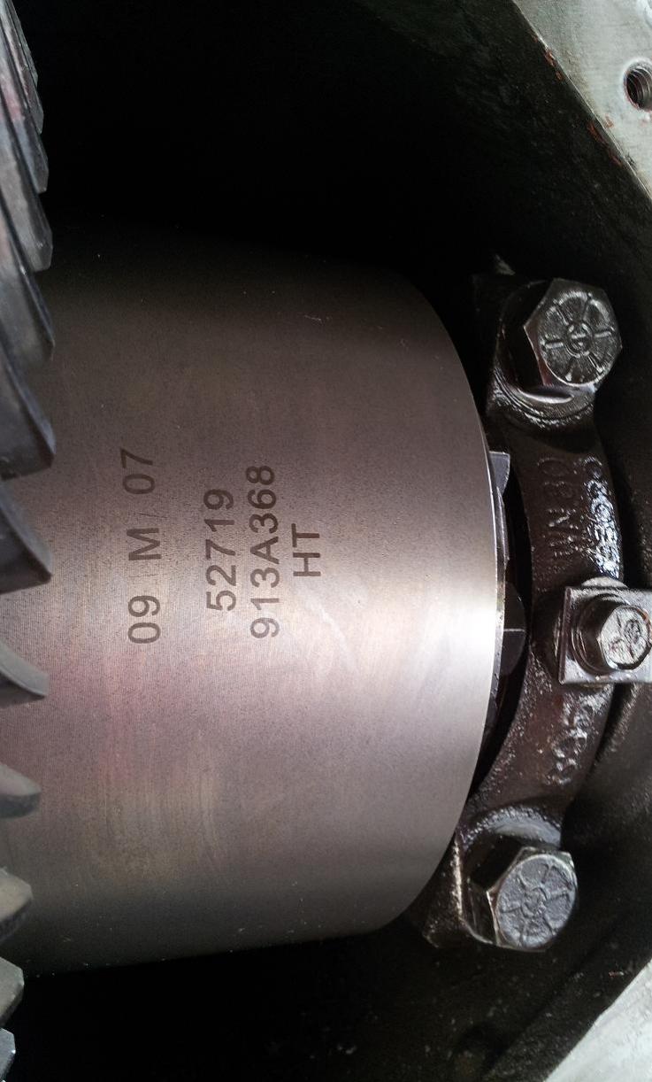

Hi everyone,
I am getting a whining noise again that is coming from the differential. I checked the oil and I don't have any metalic particles in it. I had the rear end completely rebuilt Jan. 2010. I went under truck and I found that the axle seals are leaking on both sides of the rear end. The passanger side is the worst. I got new bearings with the seals on the bearings and I am ready to install them. The problem I have is that the mechanic I took the truck to and had the rear end rebuilt, put in a Detroit Tur-Track unit in. I can't find anywhere on the internet so far instructions on how to get the axles out to change the bearings. I don't want to just start taking things apart. I am going to try and download pictures of the unit. Please let me know if any of you have had this problem and how to resolve it. Thanks. Ed

tells you how to here: http://www.eaton.com/ecm/groups/publ.../ct_128482.pdf
