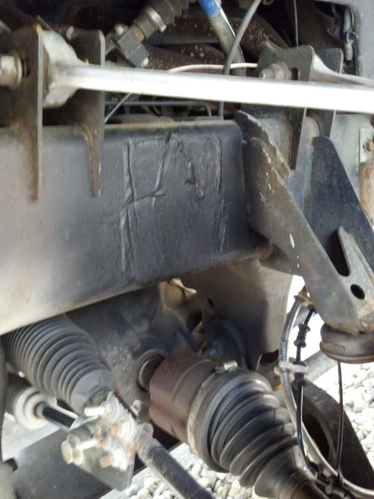

Another reason you should all change those mounts:
In that circled area, the factory mount basically is just a pocket, it holds water and is what I assume to be untreated metal frame. When I cut those sections out (Very simple, cut down the welds and hammer it off with a wedge like object) they were flaking with rust. I should have taken pictures, but I reacted quickly and ground it all away
So basically your factory mounts are raising rust and that will eventually rot through that section of the frame

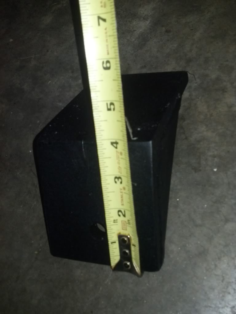

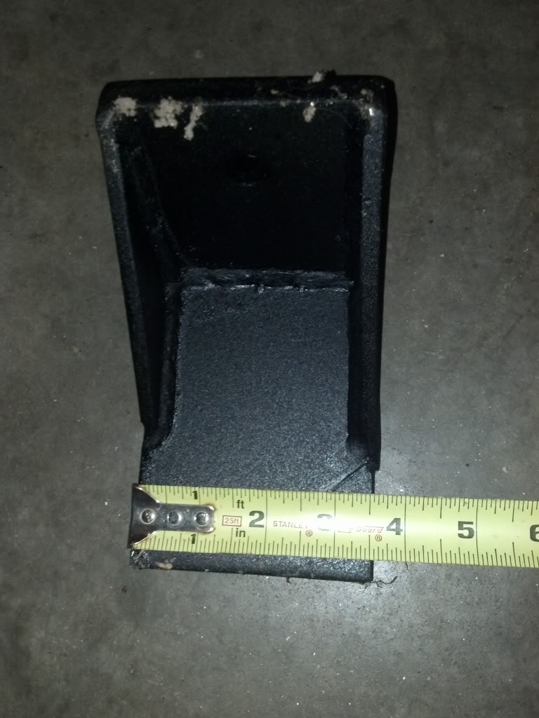

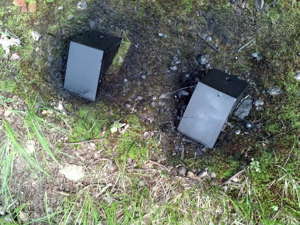

and now, more free information
3.5" wide
4" top length 1/2" hole

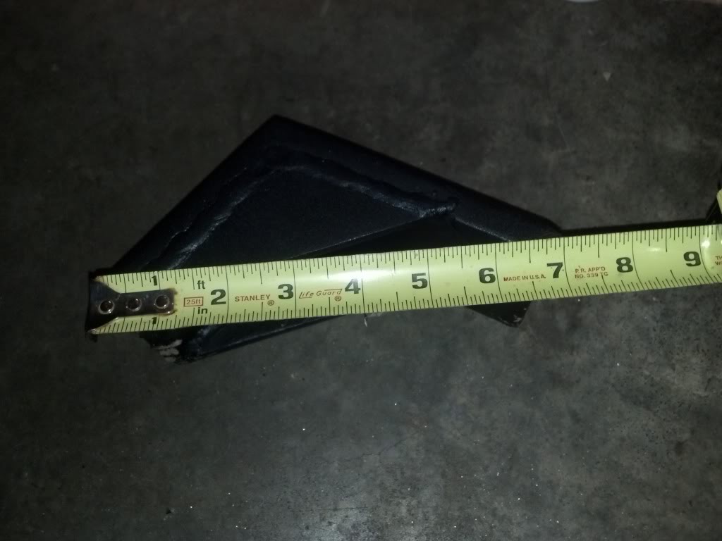

7" corner to corner

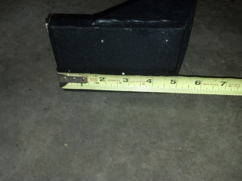

5" tall
15-25° angle. Be creative

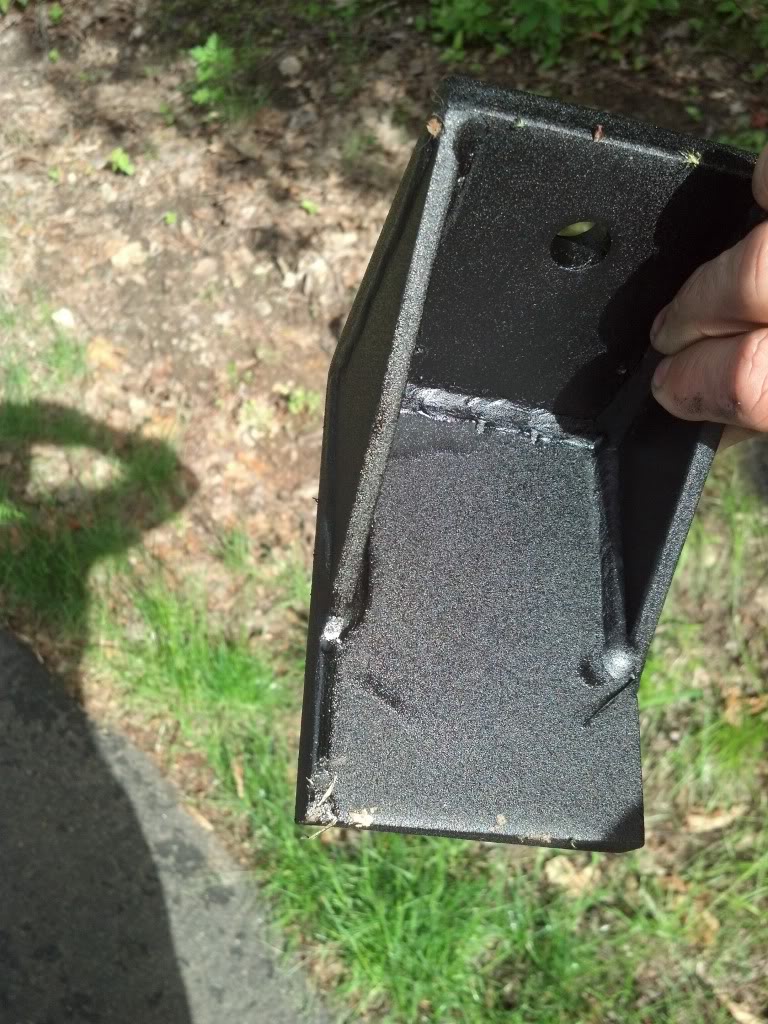

Old Jun 16, 2013 | 10:09 PM
KasperR34's Avatar
KasperR34
Joined: Oct 2011
Posts: 830
From: Wolcott, CT

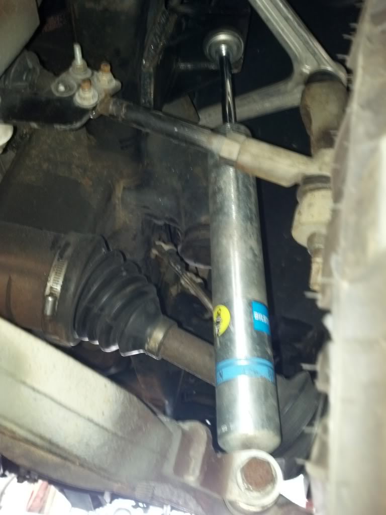

My welder challenged me and said I can't break them. So far, he's right lol

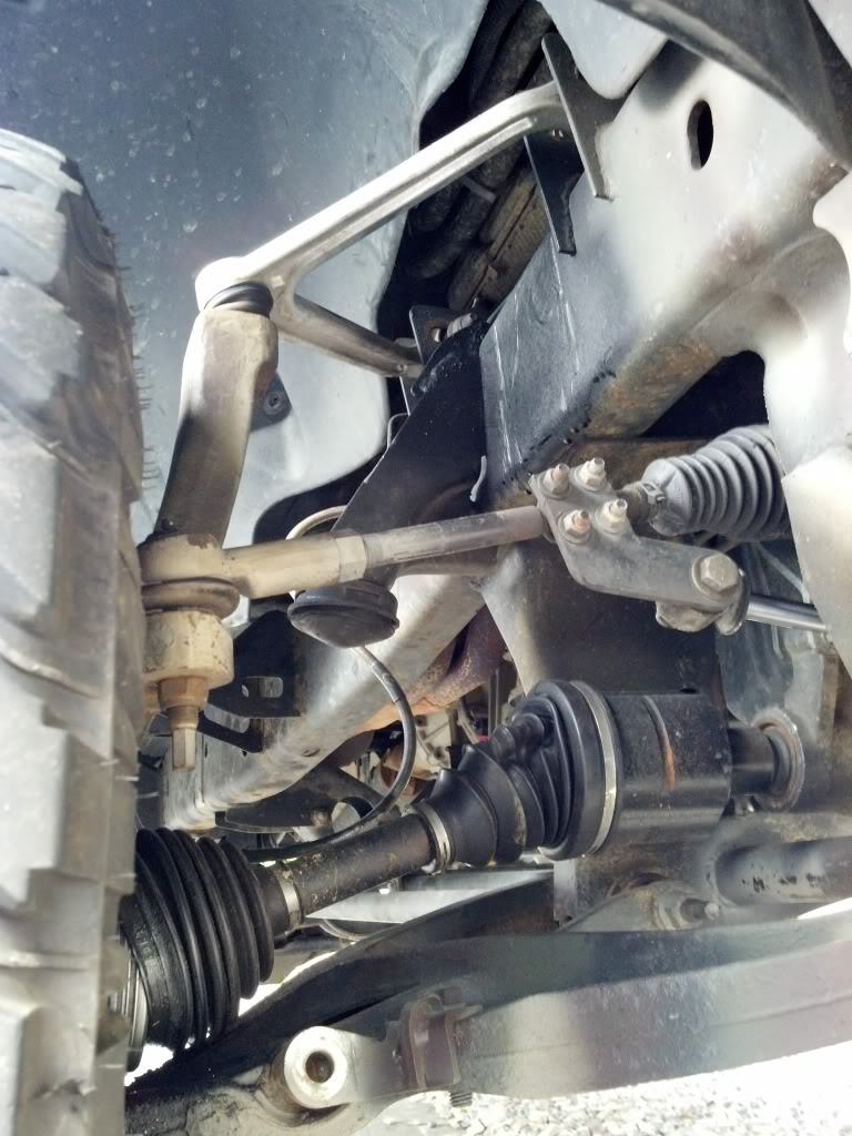

Old Jun 17, 2013 | 11:05 AM
kx250frider617's Avatar
kx250frider617
Posts: 1,562
You might want to fix your passenger side CV axle boot. It looks like you do alot of offroading so check and see if its not already worn out from dirt.
